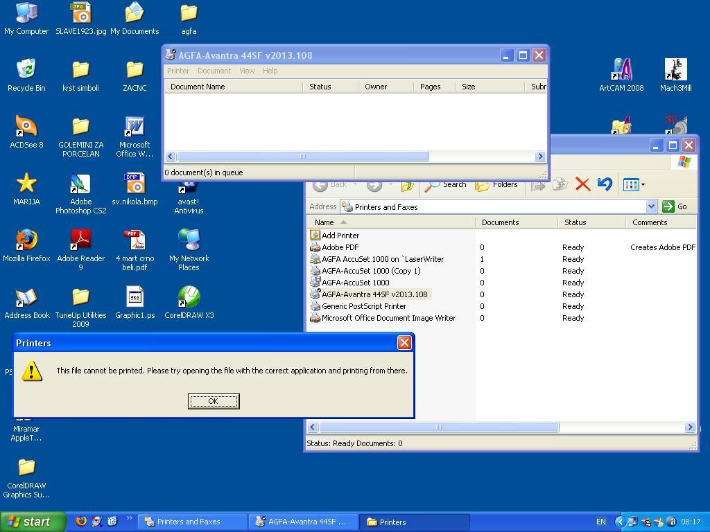

Hey guys i got a problem on my agfa star 400 Rip.I have connect my pc with the agfa star 400 and when i open the printer Agga Laser writher and drag the PostScript file into the printer it open an error message : The file cannot be printed .Try oppening with the correct name and application..
I have this film-making machin for a one month and i cannt start working. i want to say that im using windows xp ...

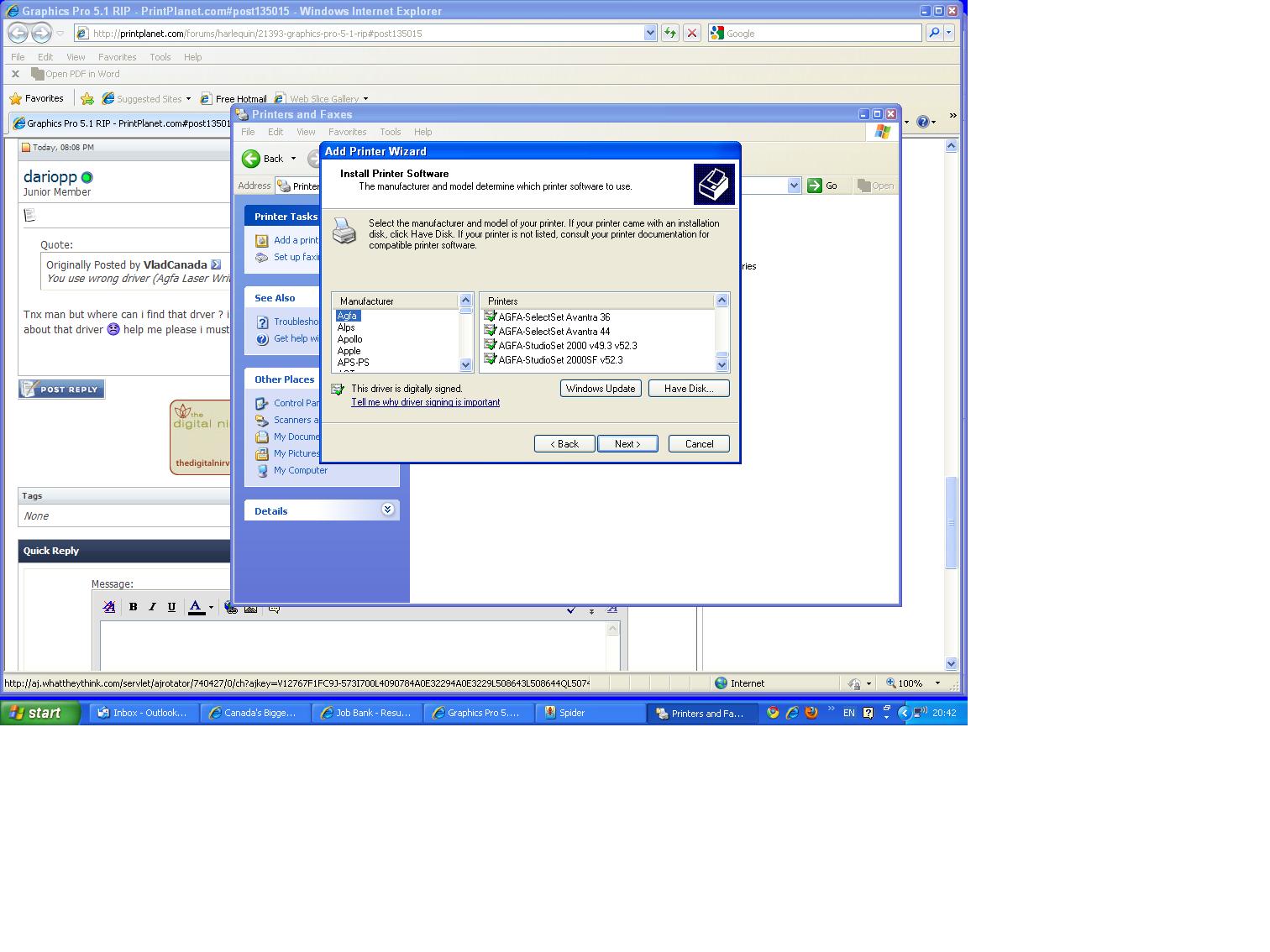

You use wrong driver (Agfa Laser Writer) created for Laser Printer but not for the imagesetter
Tnx man but where can i find that drver ? i have searching for hours and i cannt find anything
about that driver :( help me please i must start this process because its necessary for my business at this time ... :confused:
You need old style .ppd file for Av20 because you have Star-RIP PostScript level2.
Try to find via internet AgfaAvantra20.ppd ver 52.3
or use available in WinXT printer Wizard AGFA-SelectSet Avantra 20

The same problem again. ive made this picture to se how it goes .... When i drag the Graphic 1 ps file into the printer it calls this problem
The best solution for your case - download PS files via AgfaSet program.
You will be able to control Star 400 RIP in full.
And I'm saying you again - you need some special training to work with Avantra plus old hardware RIP.
