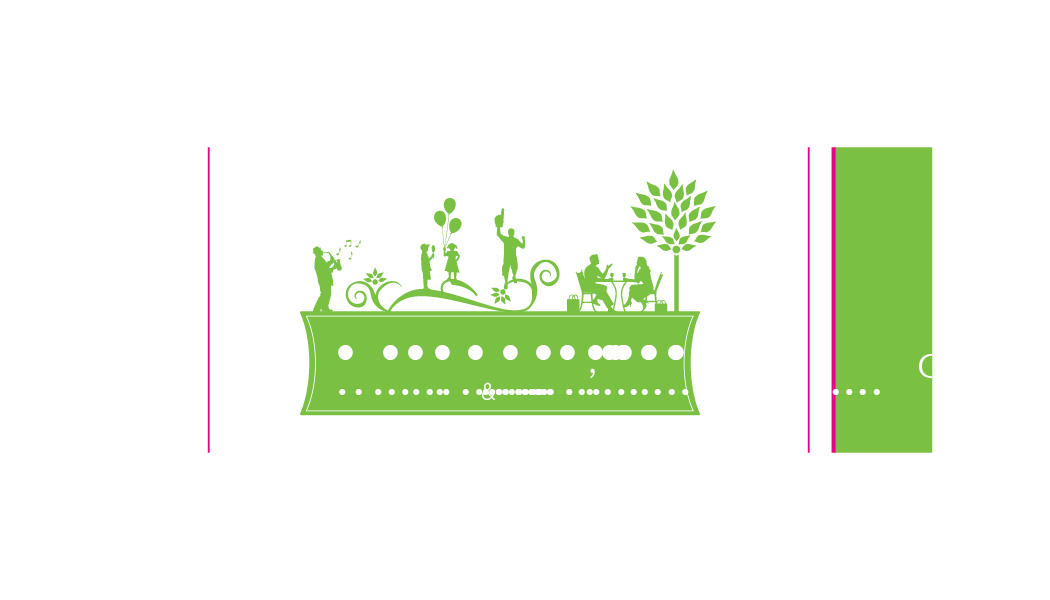

Client sent an Illustrator PDF file of a business card front and back on an 8.5 x 11 document. Edited the Illustrator PDF, saved as an AI file and placed into an InDesign document. The type on the AI file previewed with dots and symbols. (see attachment). Illustrator and InDesign file were CS3.
A day later I tried to duplicate this issue on the same computer with the same files and could not do it. File turned out fine. Not complaining, but would have liked to pinpoint the issue. I also found out from another operator on a different computer he had the same issue with CS5.
Has anyone else seen this issue?
Yes it is a font issue, it is dependant on versions of software, and flavour of PDF. I have had it happen in print but it was agaes ago. (CS4 had an initial font bug when exporting to PDF other than PDFx4) Have not seen it with current versions.
agree, font issue. I've seen this exact problem, it has something to do with the differance between CS3 and CS4 text engines.
I suspect that your client may be using an old Illustrator or PDF format.
What do you see if you open the file in Acrobat Pro? (8 or 9 would be best)
If it views correctly and your edits cannot be made in Acrobat Pro, try just re-saving the pdf (naturally with all customary settings selected including fonts) out of Acrobat and open in Illustrator.
This use to be a work around that fixed a lot of PDF issues.
It may not always be space-efficient...however, fonts should ALWAYS, ALWAYS be outlined before the file is sent to another computer.
As a designer I always save one working copy version (without outlined fonts) for myself, so I can easily make edits...
Then ALWAYS outline fonts and save that as a sending copy to any other platform.
There are millions of ways fonts can default, and not all of them will immediately seem applicable or explicable and sometimes it can be REALLY subtle, such as a defaulted font on a logo, or a completely dropped font and no one would know text should have been there.
I can't stress enough, the solution here is for your client: always, always outline.
You're lucky if you can solve it third party. There will be many situations where you can't, and we all know how tricky it can be to track down a client or correct a mistake after they may have left for the day.
