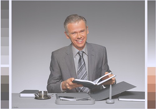

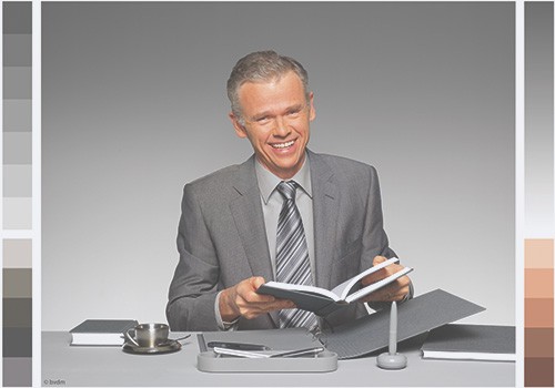

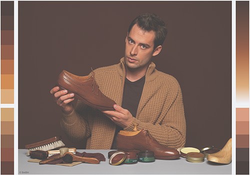

A follow up. Apparently the ICC conversion engine in Photoshop is not up to the job. I did a small test run using the ECI supplied device link profiles and Colorlogic ZePrA. I selected two relevant images from Roman16, converted them to FOGRA 52 and FOGRA 47 in ZePrA, then converted the resulting tagged CMYK images to sRGB (for display purposes) using Photoshop (Absolute Colorimetric). There are differences, but the images are very similar, and I think the FOGRA 52 versions, printed on today's OBA-stuffed uncoated papers would produce excellent results. I can supply the high-res images for anybody interested, just PM me, please.

OK, I was in a hurry. I'm trying to elaborate.
The whole point is to prove that the color conversion engine in Photoshop – in it's current state – can't make a proper conversion to the new FOGRA 52 profile. It's producing way too much magenta in the separation, that's the phenomenon the original poster was writing about.
Everybody expected – including me – that after the very successful and useable FOGRA 39, 45, 46 and 47 the new profiles will be a 'drop in' replacement. The offset printing technology didn't change too much, so why would the profiles describing the process change? According to FOGRA, the big difference is in the definition of the white point; the new profiles reflect today's OBA-rich papers, enabling a better color reproduction through the process. Eg. FOGRA 39 isn't accurate anymore since the white point representation in a softproofing scenario (or on a hardcopy proof) is very warm in comparison to a real coated stock. Enter FOGRA 51 & 52 with a definitely more blueish white point.
People try to use these new profiles like the old ones: to convert images directly from RGB to CMYK, using Photoshop. And they get inferior results. My experiment showed that – currently – we need to use some other tools and an intermediary color space to perform the color conversion. Using FOGRA 39 or the new eciCMYK as an intermediate color space, then converting to FOGRA 51 or 52 (by using device links) produce better results than going directly from RGB to CMYK in Photoshop.
I hope Adobe will address this problem in the near future, and we will be able to directly convert images with the PSO Coated v3 and PSO Uncoated v3 profiles in Photoshop.
