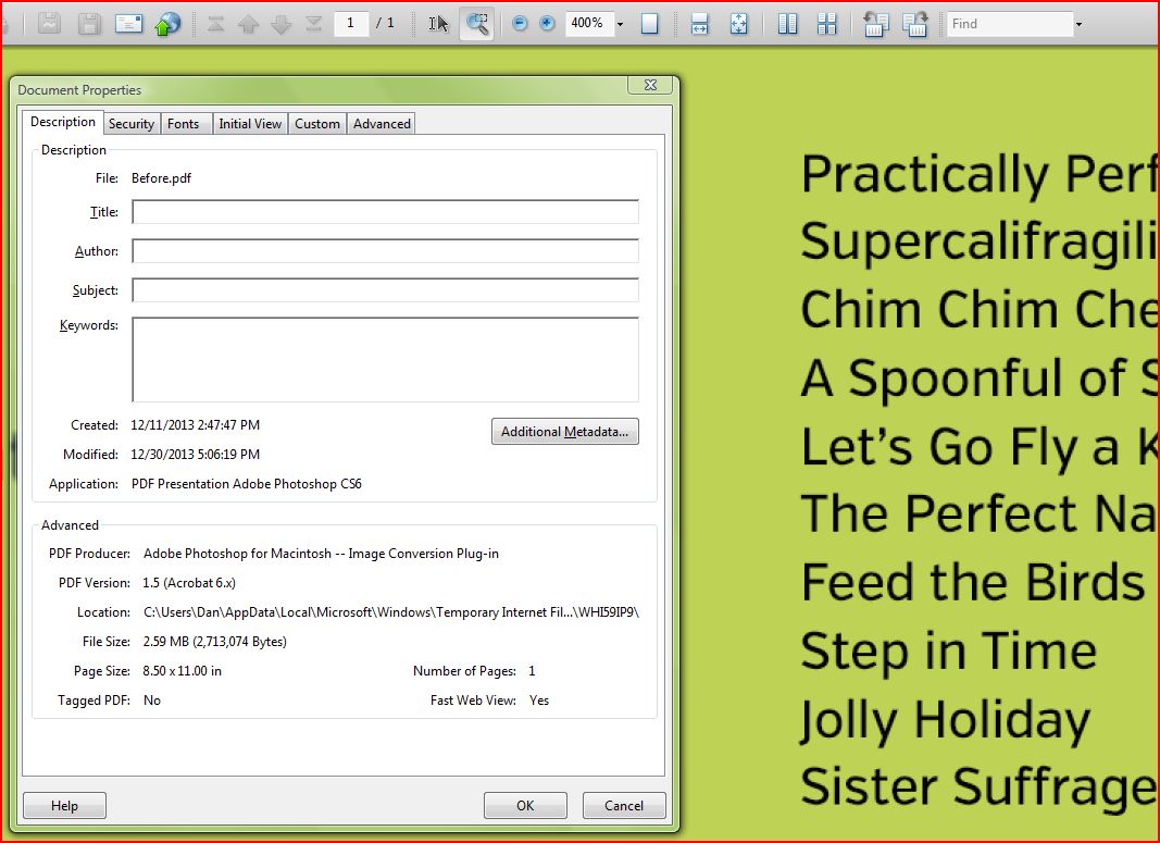

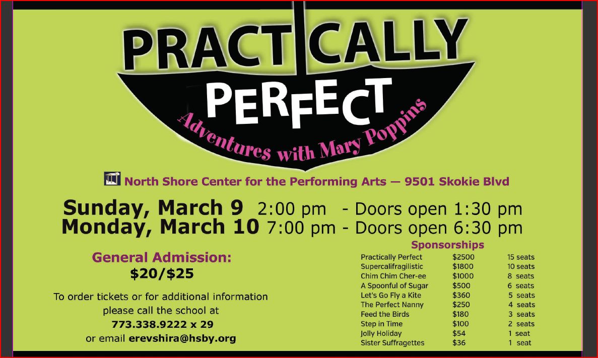

@mattbeals - Are these Acrobat default Profiles or Fixup's. Sounds simple, but I don't see options for convert to... The first file is already rgb.
I'll try to attach a ss
In the example, we have effectively one picture. Supplied pdf was created with PS. No control is available for received works.
Editing the large blaack areas is possible with PS, but obviously to tedious for the "type" areas.

Content that is obviously vector should not be supplied as raster (I’ll get off my soapbox now). The sample image was probably setup by somebody at the theatre company that does not understand newsprint (or any press) reproduction. The resolution of the raster file is probably too low as well.
Converting RGB photos to CMYK is one thing, converting graphical elements such as logos, text and “art” is something else.
If the RGB ads are supplied as images and they contain content that should be both raster and vector, chances are they are not supplied as PSD/TIFF/PDF using vector text layers set to multiply blend mode.
Presuming that the RGB black elements in the Photoshop art are not setup as layers in multiply blend mode and that a Max. GCR separation is used… There will be no underlying CMY tones, so one may need to introduce trapping in the Photoshop art to account for mis-registration. Sadly, web printed newspapers often have huge mis-registration issues.
Even converting to a Max. GCR style profile will not cure all the possible issues with such content. Going to a Max. GCR style conversion will just trade off one set of problems for another.
Ideally, there would not be any holes in the CMY under the fine K text elements (black overprinting) - however if the job was supplied as a flattened RGB image with no multiply layers for the black content, then these ads would need manual retouching in CMYK to fix them up for best possible reproduction. For many reasons, this will probably not happen.

This isn't the actual file I hope. Send me the PDF .
@Stephen Marsh - ok, so my ignorance of PS and GCR is not the hurdle here. A global replacement of cmy to k is pretty difficult if not impossible to achieve.
@mattbeals - yep, actual art file as received - as I prefaced, this is not a perfect world. That file is an actual file and is representative of what any full rasterization will result as; Word Art, PS export, the possibilities are large.

You mentioned that PDF ads were supplied created in Photoshop. The sample screen capture showed a job that should have been created as vector, not raster - there was a large amount of small type. As vector elements such as type are rendered at resolutions 1200dpi or higher, a 200-300ppi file that has raster type will be visually poorer. Effective resolution for type is different than effective resolution for newsprint halftones. Now, I am only guessing that the Photoshop PDF raster ads are flattened, they could be supplied with vector content layers for all I know. I can only guess by past experience.
