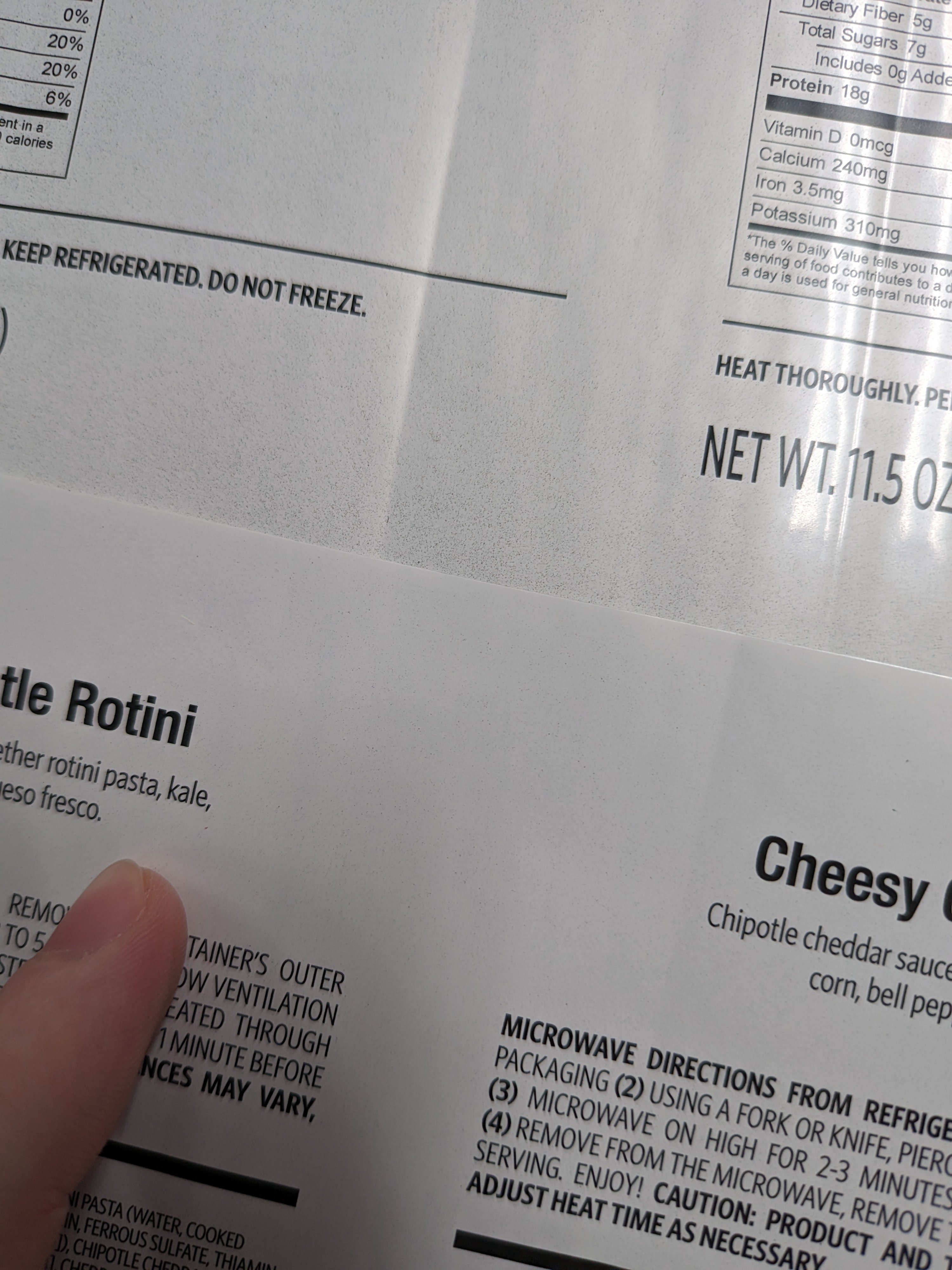

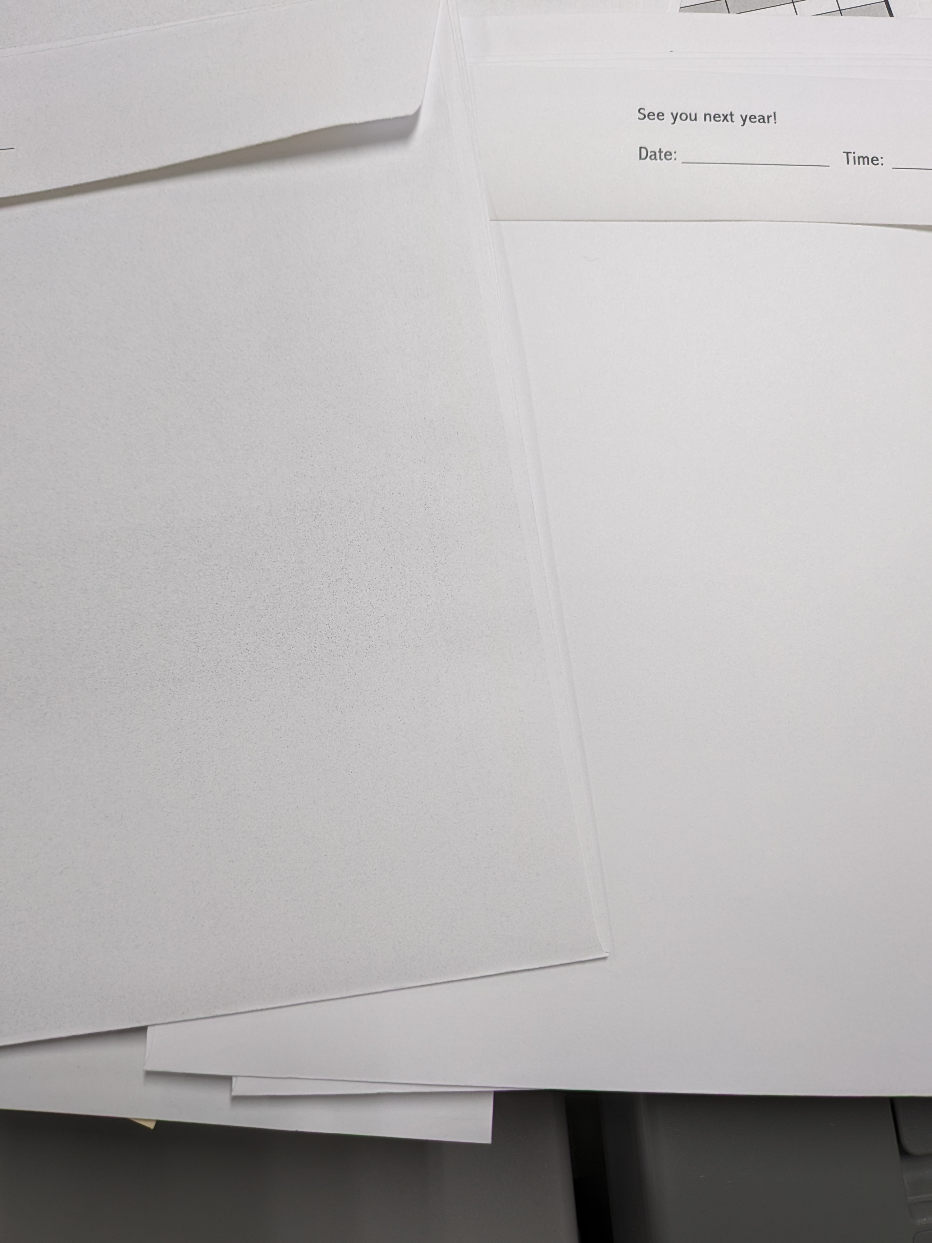

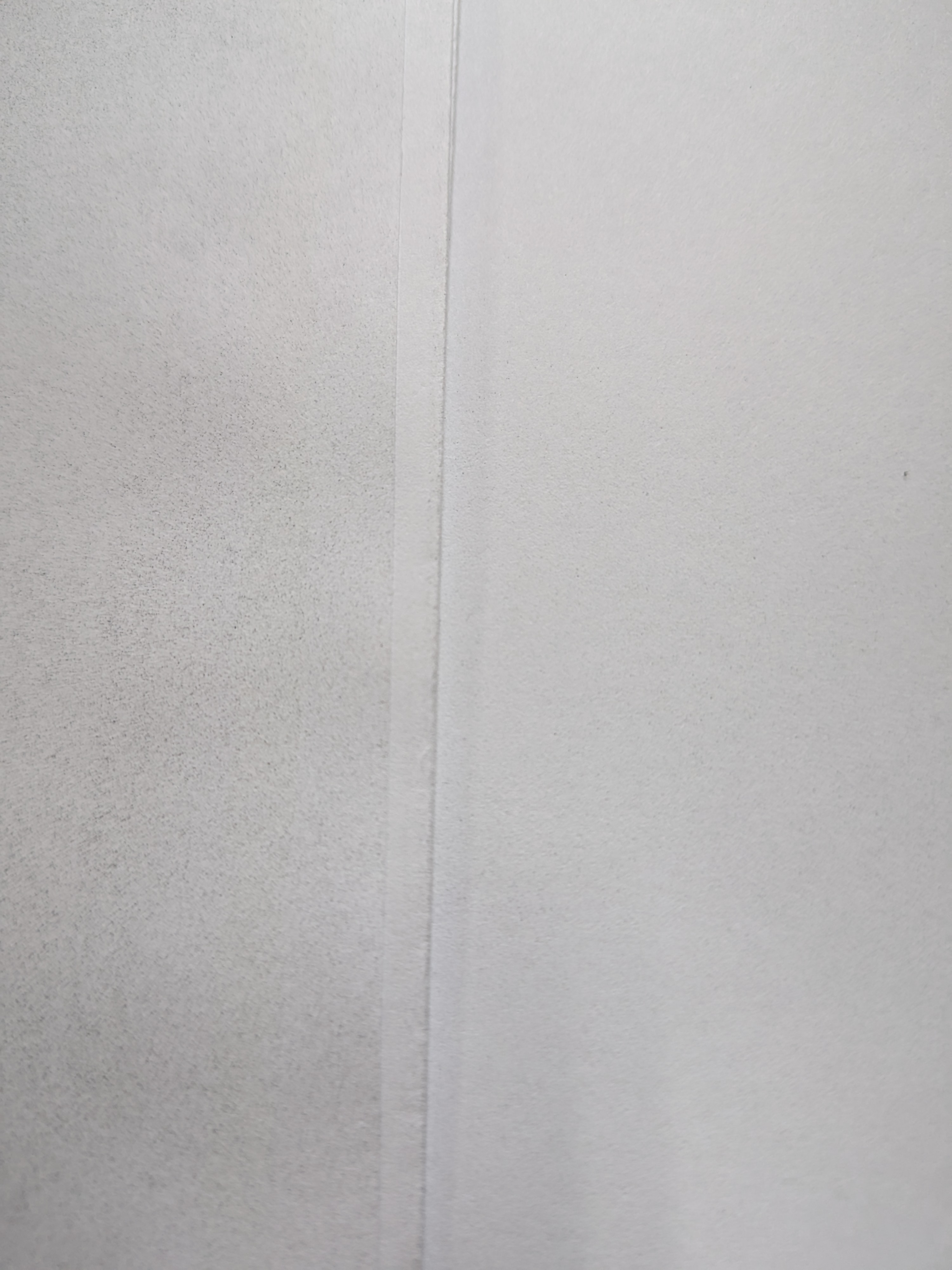

I've been banging my head against the wall for weeks with this issue.
I have a Ricoh Pro C7110x that will print about three sheets just fine, and then start getting this horrible, really heavy scumming over the entire sheet - almost like it's trying to do a very light flood coating. Images are attached (Hard to see in a picture, but it's blatantly obvious when looking at the physical sheets).
I've tried so many different things, adjusting the Image Density settings, using the Image Density Adjustment: Manual Execute setting, using the Adjust PCU Potential settings, absolutely nothing works. My local Ricoh technician has been out here many times trying to solve the issue, but it never goes away fully, and is always back in a few days.
I don't know if maybe humidity or temperature are throwing the machine off, but it's well away from the doors of the shop in a climate controlled building, and the relative humidity is quite low.
Any help would be appreciated.

My Ricoh doesn't actually have a copy function, so no glass to get dirty in the first place. The PCU cleaner is getting replaced soon, but the issue has been going on for far longer than that unit has needed replacing. I don't think we've tried to do anything with the developer or developer unit yet though, and I'm unsure if the charge roller has been changed. I don't get to talk directly to the tech every time he's here, so I may have missed it if it happened. Appreciate the suggestions though, I'll be checking with my tech next time he's here.
What did your service provider say? My guess is a leaky developer housing.
We've gone through a lot of different issues, we thought that the issue was due to weird paper catalog settings at first, and then a few other minor issues, but still nothing. I don't think the tech has taken a look at the developer at all yet, I'll bring it up next time he's here.
Ahh ok, you wouldn't be familiar with the glass I am talking about, tell the tech to check the glass as well and he should know.
Update: The PCU cleaning unit was replaced (regular maintenance), didn't make a difference, as I suspected. The charge roller is practically brand new. The developer housing hasn't been touched since before we got the machine over 4 years ago, and the developer unit is like 80% of the way to being due for a change anyways, so we're going to just put in a new developer and housing, and replace the black drum while we're at it just to be sure, as it's getting close to needing to be changed as well. I appreciate the input, I'll let you all know if that works for us.
