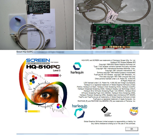

I think the best and inexpensive option close to your RIP configuration and HW-776(not available widely) is
Screen HQ-RIP 510 V 6.2+T2000 Interface card, Installation and Operation Manual+Dongle and Cables. It works very well with all Agfa and Screen Image setters. If you need more information, contact me [email protected].
