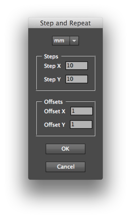

After some discussion on LinkedIn, look what was finally offered by a fine fellow named Vasily Hall…
The first two fields are the final array, including the original object/s. So starting with a single original, one would enter Step X: 2 and Step Y: 4 if one wished an 8up result in two columns with four rows.
The second two fields are the gutter/gap between the rectangular bounding area of the original object/s.
  • StepAndRepeat-VasilyHall.jsx.zip
