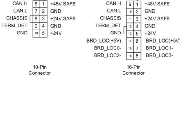

Hi Adnan,
I have encounter similar behavior in past. Problem could be related with power supply for security loop. Everything seems to be OK for a period of time and suddenly machine gone crazy. I found that a fan on power supply is stuck and module slowly is heating up until enter in protection mode. Check the fan for PS2. If is not working change the power supply.
CAN terminator
CAN terminator
Adnan, picture for you....
