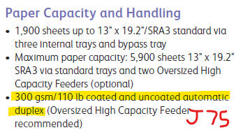

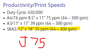

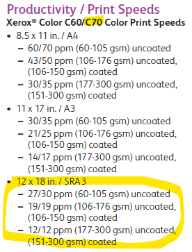

@jpfulton248 , since you said you mostly do 65# cover, I'd caution you on the C70. The replacement for the J75 is the Versant series. The C70 is more of a light production press. It slows down significantly for cover stock, where the J75 maintains full speed for all stocks. Additionally, the J75 can auto-duplex up to 300gsm, where you have to manual duplex anything over 256gsm. I realize 65# cover you run is less than 256gsm, but it's worth noting that it is a downgrade from what you currently have. If budget is an issue, then the C70 will get the job done, only slower than you're used to. Look at screenshots of the specs below:

Wow. Thank you. The auto-duplexing issue will certainly be the occasional inconvenience. The slower speed is much more of a deal killer. The issue is indeed budget. The J75 we are currently running was purchased used with cash and now our service provider is kind of doing a rug pull. A month after signing, payment and installation, the service provider told us they had to shorten the previously agreed upon (and signed) guaranteed 10 yrs of service. They told us the higher-ups wouldn't accept the contract (even though it was signed by our sales guy) and they shortened it to 7 years. We obliged and since then forgot all about it. We are now at the 7 year mark and they are kicking us out of bed. Since we own the machine, we have no incentive to upgrade to a new one. They are showing us numbers on the C70 -- service plus lease -- and the payments are just slightly less than what we are currently paying on service alone. We could almost get by with the C70 but that speed reduction will be unbearable.
