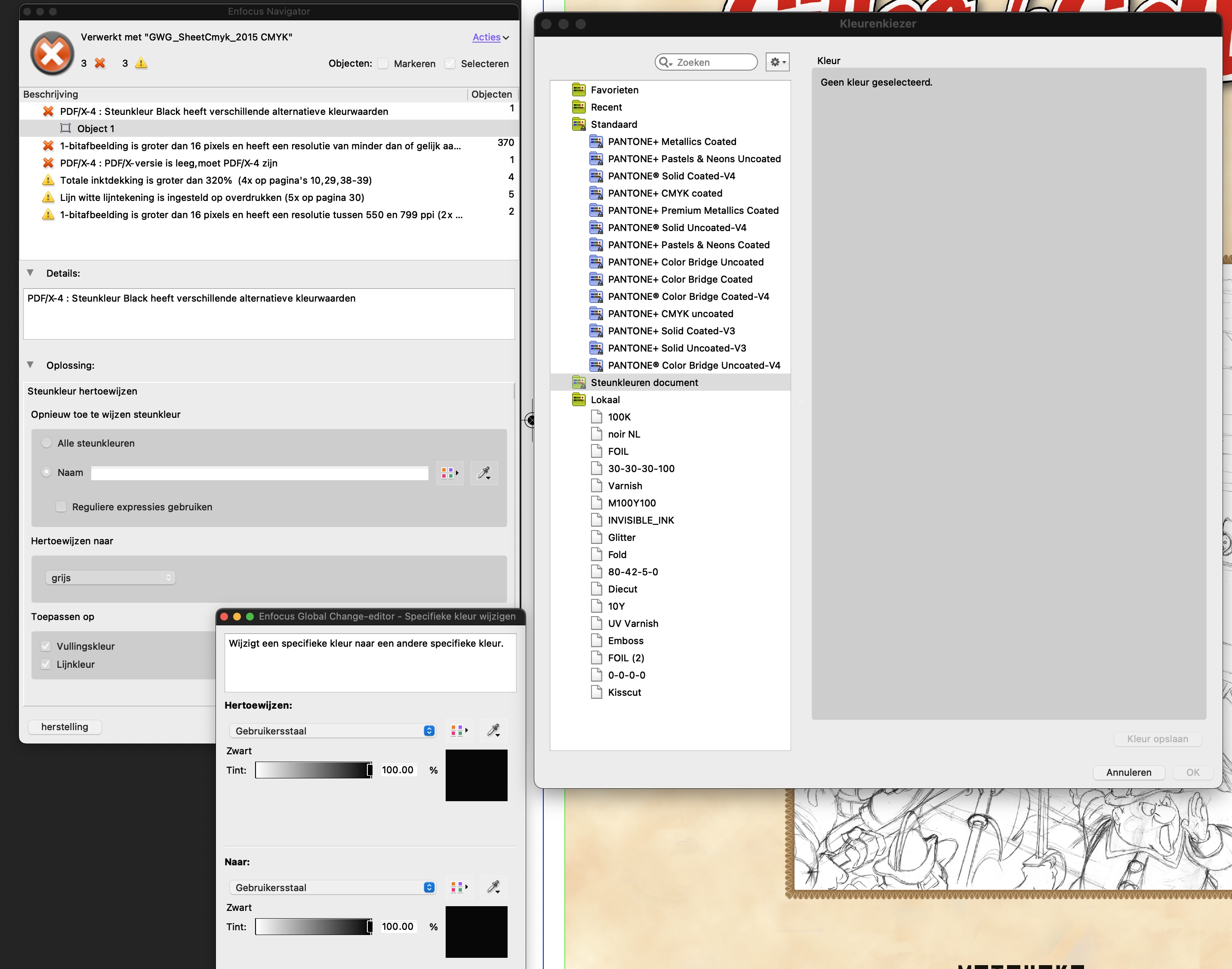

Hi! I get this error 'Spot color "Black" has different values', but there's no spot colors in my document?
Running actions 'change all to CMYK' and 'Change Specific Color' have no results. Please see screenshot.

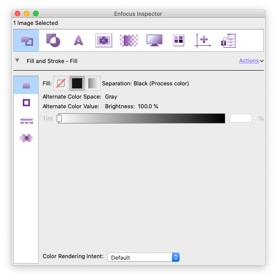

It's the black and white images, if you click on them you will see they are colored Separation, with an alternate colorspace of Gray.
So technically 'Black' is being described in different ways in the document.
The error message could do with a bit of tweaking, but I think it's part of the built-in PDF/X-4 checks, rather than a specific GWG requirement.
Either way, converting them to CMYK resolves the issue for me. I've attached the Action I used which selects separation colors and converts to CMYK, you could also use Grayscale if you want as the Black does have an alternate colorspace of Gray.
Obviously please check the results to make sure they are ok, I looked at the pages I had and they separated to just the K, so they did not become 4-color blacks. The result then passes the GWG preflight you have.
