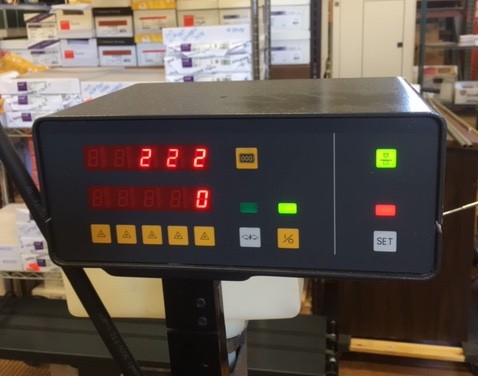

Pressman is having an issue with using the panel on an AB Dick 9920 (same as Ryobi 3200)
Someone told him how to set the double sheet but now he forgets, and can't remember what the buttons on the panel do.
Can anyone explain the functions, or have like a manual page that shows the button functions?

press set button, feed 4 sheets, light will go out double sheet is set. there are a couple switches on the back they need to be in the up/on position. there also is a sensor under the feed roller that must be clean or it dosent work.
