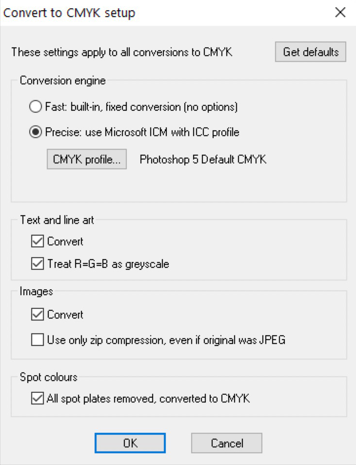

We are a Mac shop (Digital Presses) with the exception of one major account and its on a PC. We use the latest version of Acrobat and Pitstop with an Acrobat plug-in called Quite a Box of Tricks. All the work comes in as RGB, usually created from Excel and Word docs. This will not change because the customer is a Financial Institution and not a printer and just wants it printed as is. After preflight, the supplied PDFs are RGB and fonts are not embedded so we re-postscript all files utilizing Distiller to embed fonts and than convert all RGB color to CMYK utilizing Quite a Box of Tricks v1.8i. Its an old workflow thats worked for years and I recently inherited the account. Yay! The issue is that on the we installed the latest Acrobat and it’s now a 64 bit app and Quite is a 32 bit app and will not work together. I need to match the old RGB to CMYK color conversion from Quite a Box of Tricks of previous jobs to a new Pitstop color conversion. This is for new jobs to match color from older jobs such as reprints. In the Colours tab we select “RGB Gone” Convert all colours to CMYK if needed for colour separation. There is a Setup… box to click on to change settings and when opened it says: Precise: use Microsoft ICM with ICC profile. Under that is a Clickable box saying CMYK profile.. and the selected profile used is: Photoshop 5 Default CMYK. I’m stuck on how to arrive at the conversion using Pitstop to match or come close to that conversion. Contacted Quite and they will not be updating the app. Any help would be greatly appreciated. Thanks.

You won't be able to use the Microsoft ICM, that's not available.
You'll have to use the Little CMS CMM
I would suggest you look at the 'Just make my Office PDF work! - CMYK ISO Coated v2' Preflight profile.
Copy it and change the destination profile in the Color Management settings so your destination profile is the 'Photoshop 5 Default CMYK'. You might not see that profile in the list of profiles, so you may need to find wherever Photoshop or Box of Tricks puts it, and move it into the ICC folder that PitStop uses.
This Preflight Profile does a lot more than Box of Tricks (eg adds Bleed etc), so you might want to actually remove some of the Action Lists. See what results you get and compare and adjust as needed.
abc
In addition I forgot to mention, this profile generates a PDF/X-4 file. If you want to retain that you should probably add the 'Photoshop 5 Default CMYK' Profile as the Output Intent.

Thank you abc. I'll give this a test later on today. As always I appreciate your help
