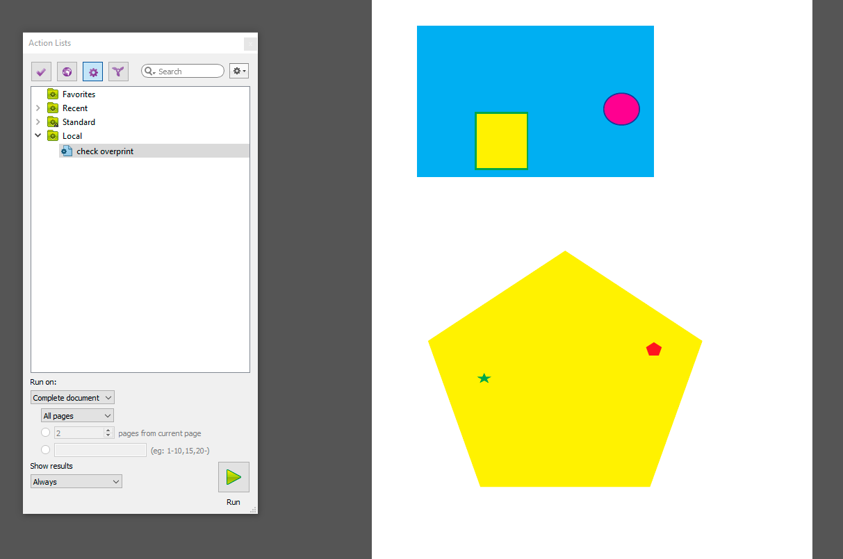

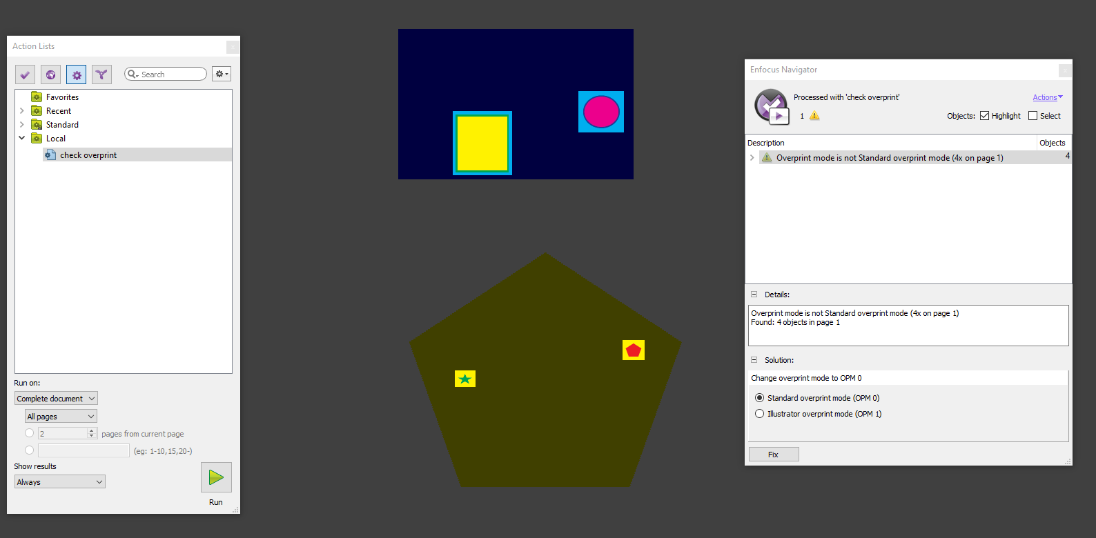

I attached an action file, remember use Show Results ALWAYS
then you will be see this
  • check overprint.zip
