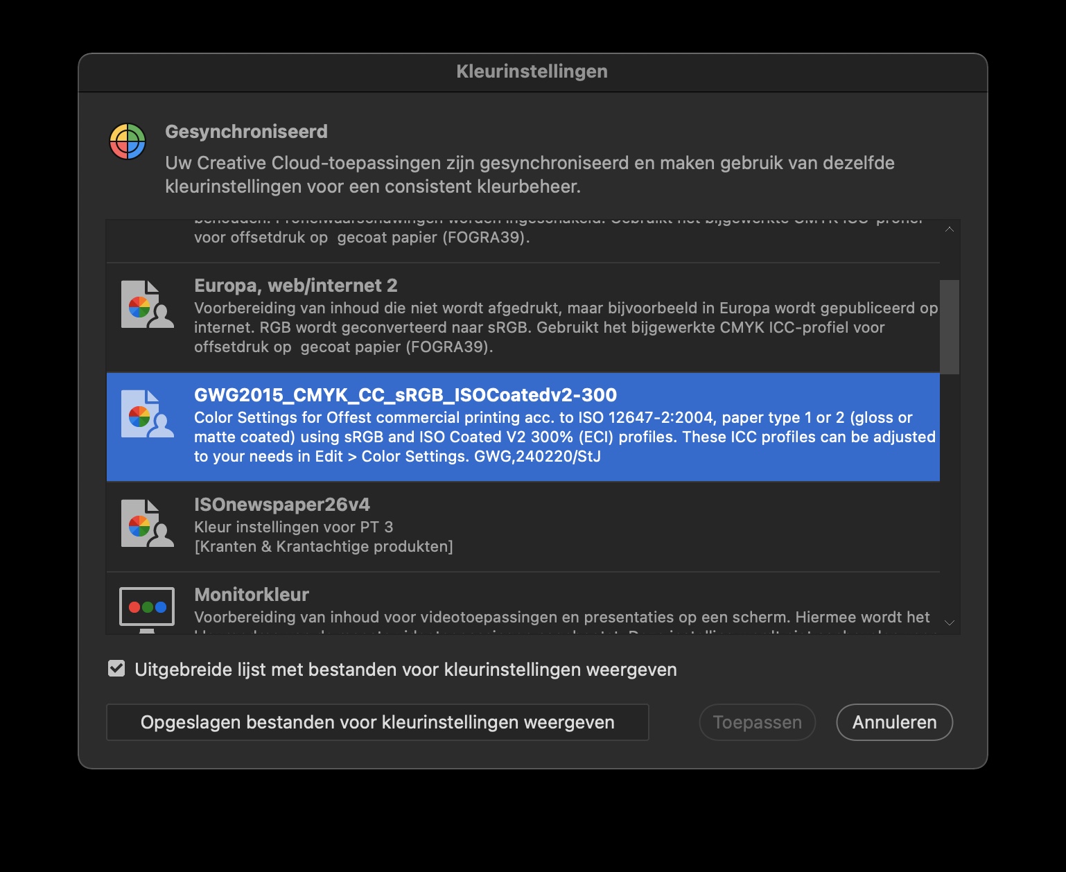

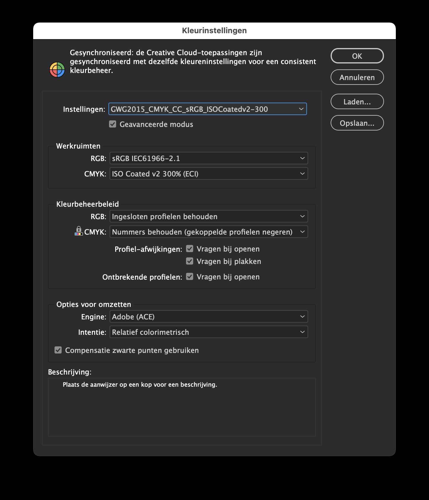

I'm experiencing a strange behaviour in my Color Management: I'm using Adobe Bridge 2022 to make sure all my Adobe apps are using the same color management: GWG2015_CMYK_CC_sRGB_ISOCoatedv2-300.csf which uses ISO Coated V2 300% (ECI) for the CMYK. (please see screenshot 1)
InDesign (17.0.1) then has the correct color settings (please screenshot 2)

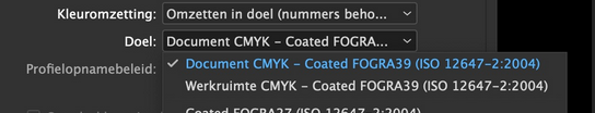

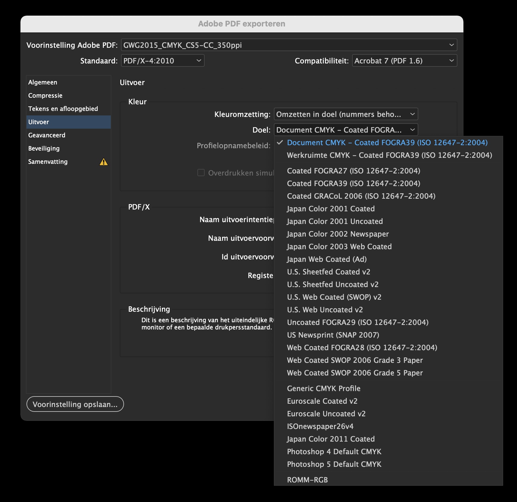

But: when I try to export a highress pdf (PDF/X-4:2010) the dialog states that my working space is Coated Fogra 39 instead of ISO Coated V2 300% (ECI)
(please screenshot 3)

Ulrich
Did you build yourself the current document you want to export or are you working in an "existing" file maybe from another one or modifying one from an elder archive?
background: current application und opened document must not have the same workingspace (icc-profile), check your preferences for opening, you should be activate a warning if it is not the same by opening...

jonasukulore
Thanks for your quick response! Sorry about the Dutch-language screenshots.
"Doel" (I think) is in English "Target". ("Instellingen" = "Settings" / "Voorinstelling" = "Preset")

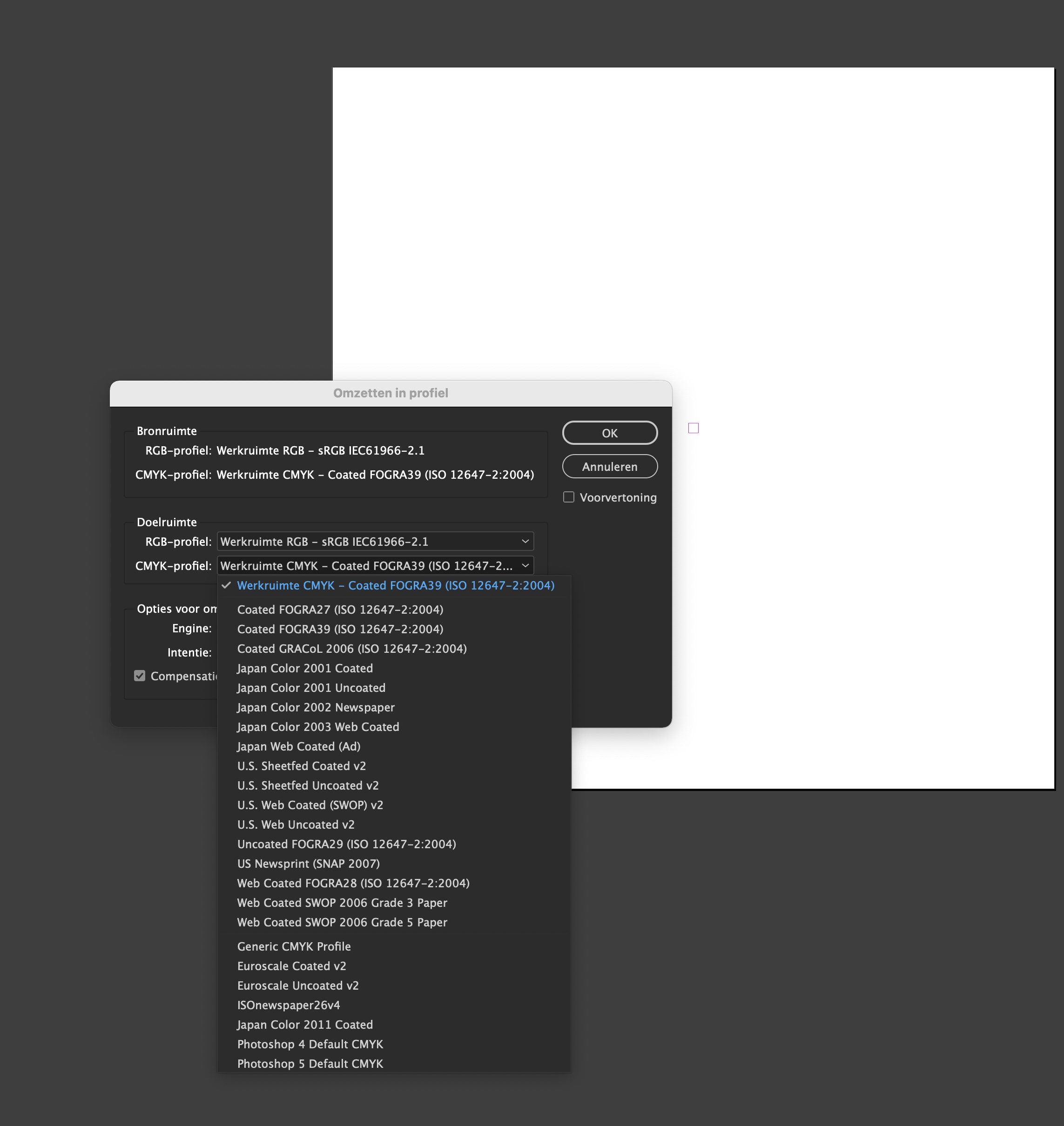

Even if I make a completely new blank InDesign document (with the colorsettings In Bridge set to GWG2015_CMYK_CC_sRGB_ISOCoatedv2-300.csf)
Indesign seems to be set to Werkruimte (Working Space) Coated FOGRA 39. And no ISO Coated V2 300% (ECI) or GWG2015 to be found in the "convert" dialog?

ISOCoatedv2-300 is not listed in your scrolldown-screenshot above, is it not installed in your system?
i mean just loading the csf-file (settings) is not enough may be...

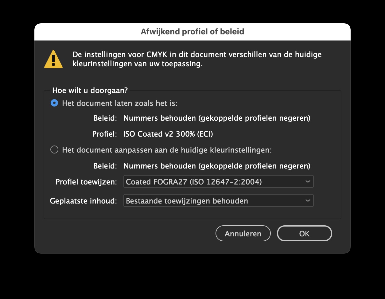

I tested opening a file I made myself a couple of months ago with the GWG2015 css file / ISO Coated v2 300% (ECI) setting. It always opened without dialog.
Now when I try opening it in InDesign ) I get this warning

jonasukulore
That's indeed strange, I noticed it too. I think it is in the right place - it's here:
\Users\MyName\Library\Application Support\Adobe\Color\Settings\GWG2015_CMYK_CC_sRGB_ISOCoatedv2-300.csf
jonasukulore

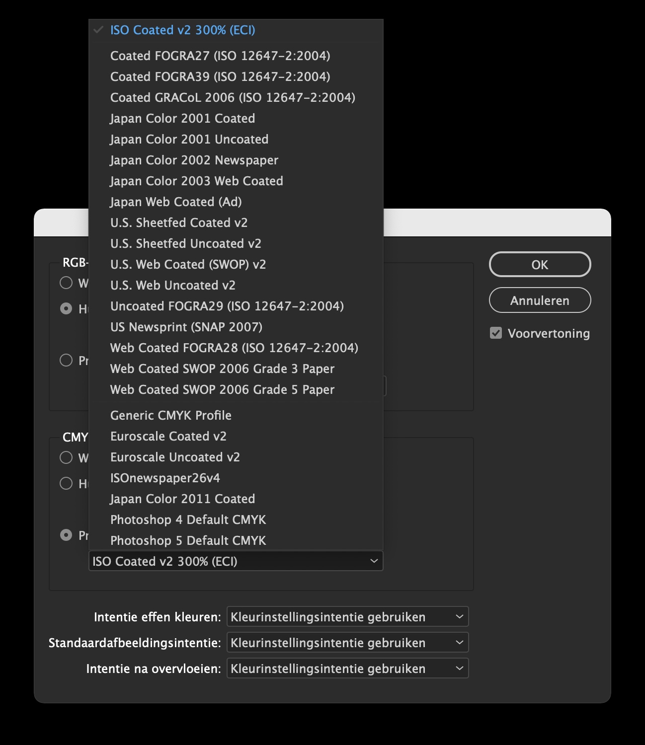

I think I've found it! I've deleted this .csf file, downloaded it anew from the GWG (Application Settings) and I think we're back in business!
Perhaps updating to the latest versions of CC jumbled up the .csf file?
Ulrich
for the settings might be yes, but i would check/try to place the recommended single icc-profiles here too:
MacHD-Library-Application Support-Adobe-Color-Profiles-Recommended
...but my System is really not up to date and i am not working with the CC-Versions, so might be another one with more modern equipement here is able to help you more?
Puch
Ulrich is right, you have to have the actual ICC profiles in place. The settings file contains references, but not the profiles itself. The place where the ICC profiles should be: /Library/ColorSync/Profiles. If you place the profiles into the Recommended subfolder (actually an alias to the Adobe profile directory), those profiles will appear up in the list - "they're important".
jonasukulore
Thanks Puch and Ulrich!
I've placed the file ISO Coated v2 300% (ECI).icc in \Library\Application Support\Adobe\Color\Profiles\Recommended
and \Library\ColorSync\Profiles
All seems to be working now. Strange that before the .csf (for a while) references seemed to be working, even if the .icc profiles themselves weren't in those locations. Anyhow: much appreciation for your kind help!
