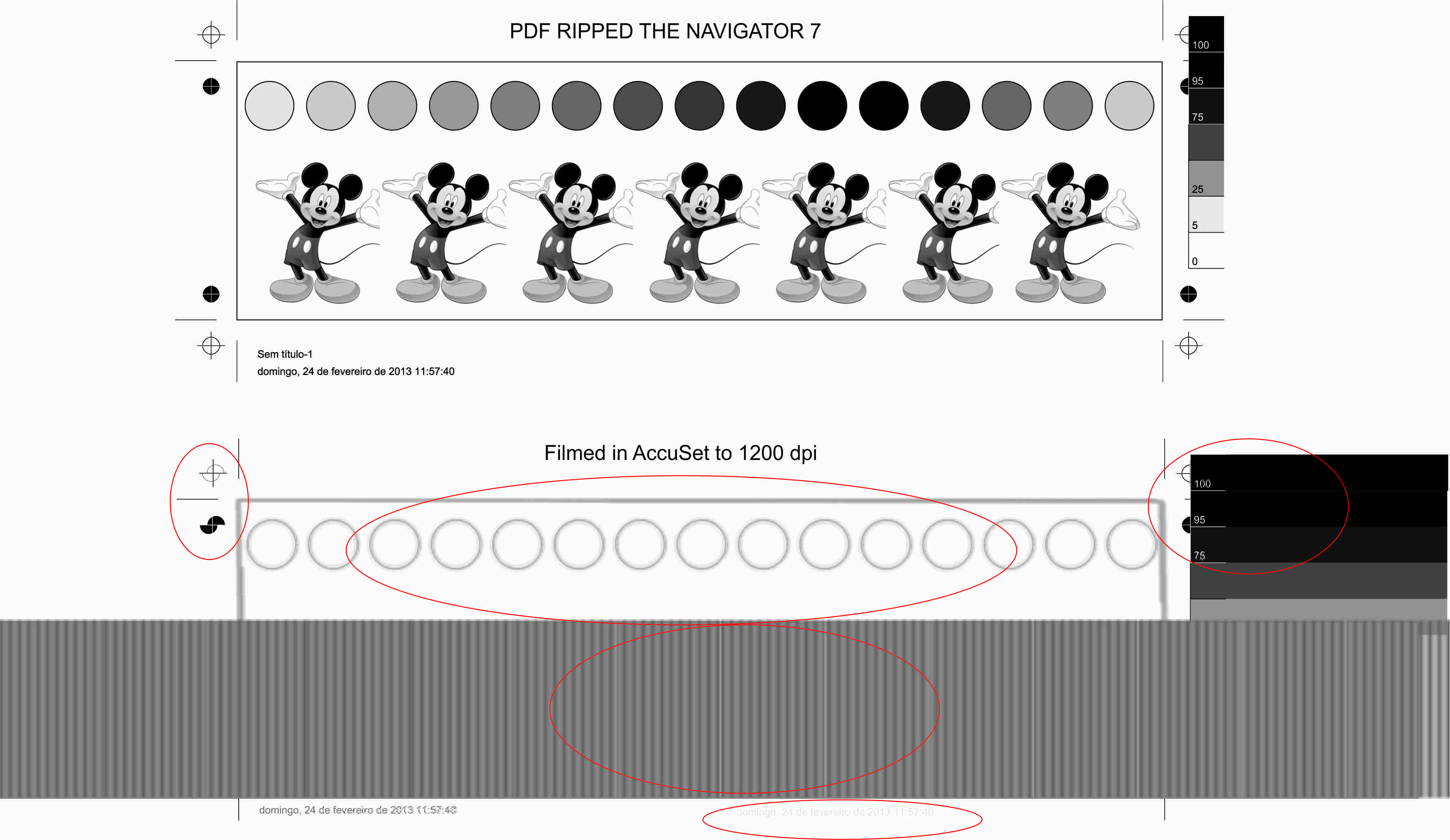

I'm posting an image that simulates the result I get in the output of films.

You can use the same long APIS cable for Taipan and HW RIPs because APIS protocol of data exchange wrote down in one of the chips installed at HW interface board.
APIS cable has only straight wires, no twisted pairs itself.
So, if the same cable was good for Taipan RIP when Accuset was demonstrated to you before purchasing, that means for me: cable OK, as well as flat cable inside the Accuset.
I installed enough Accusets with non-AGFA RIPs in my practice to say that.
By the way, your example impossible to be viewed to say more about the problem.

I did not get on when you say that my example is impossible to be seen. I understood about when you say the flex that is inside the AccuSet serves both as to ApisCard to HWcard. I suspected the cable by having seen the name of this same site: http://www.bob-weber.com/parts/part.aspx?modelid=248. (see third item.'s the same cable installed in my AccuSet)
Because the sample can not be seen I will describe what happens:
- The images appear distorted, blurred, exposure of 127 is not enough, the picture gets blurry Even then completely distorts ... instead of the reticles accusete draw straight lines ... the distance between a page and another is approximately 7cm. Feels that acusset works slower than data transmission. Seems missing synchronization between HW and board AccuSet.
