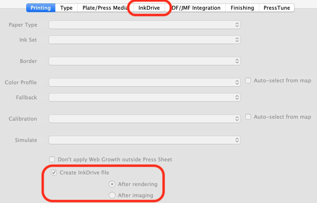

Hello to all,
How can i see if my Apogee 8 Rip have the option ppf/cip3 option enable?
Where i can check this ?
Regards
Masterpc
prepressdork
Hi masterpc,
CIP3 data is generated via the Generic Press task processor. If you have the necessary licensing, you should have an 'InkDrive' tab and options for when to output the data. See the following image:
