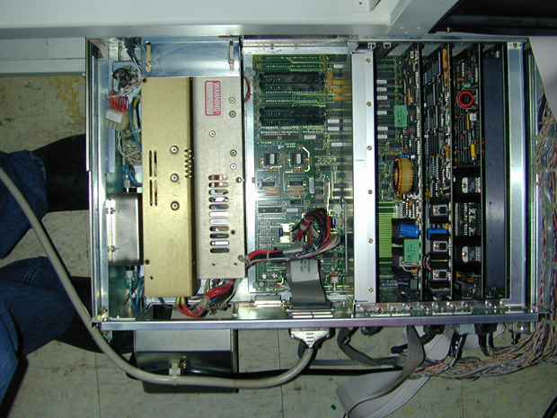

I have a select set 7000 that is not booting up. When I turn the power button on I can hear that there is power, the display stays blank and laser carriage does not move. I have replace all the boards with a spare that I have along with the display and the power switch. Does any one else have any other ideas. I have read on a previous post about ROM modules and a Dallas card but I am not sure what those are. I have attached a photo of the computer area if that is helpful.
Any help would be appreciated.
Thanks
Damien

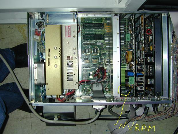

Dallas NVRAM
Boot ROMs have stickers 290190-005 &-006
or -007 & -008
or- 009 & -010
and check all DC power sources. especially 5V
