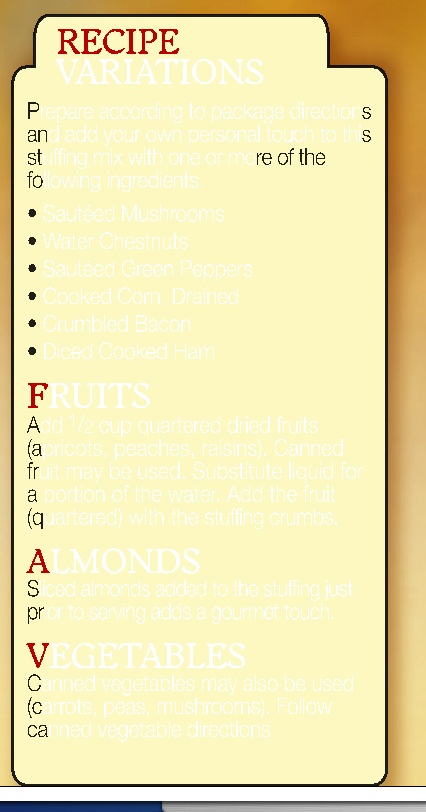

We tried this on a file that was giving us problems and it seemed to import better. But it still shows as a mapped picture instead of black type. When we click on this black type and hide it the text looks like it is knocking out the background color. If we turn off by color this anomaly does not appear so we are afraid to trust what we see. I am going try and show you a screen grab to better show what we are seeing.

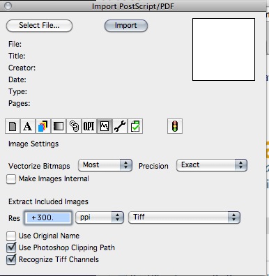

If you have already verified that your vector text is on top of all rasterized and blurred images in illustrator and still have this problem, try the following:
In your Nexus Manager try adjusting the Importing module in your workflow, Image settings you have 3 choices; Never, Most or Always.

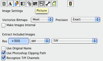

DO you mean this panel. the setting never, most or always is only for bitmap.

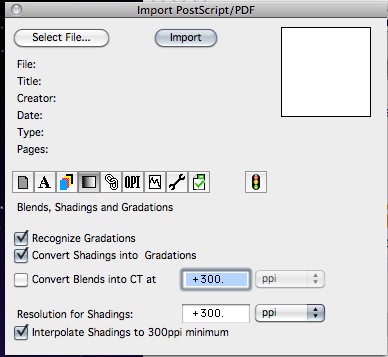

1 Try not to use CS2 (this was a verry bad version), use CS3 instead
2 Check in Illustrator that your Document Rastering Effects are set to High(300ppi), you can find this under Effect > Document Rastering Effects Settings. Also check that Preserve spot colors is on. Keep in mind that when you change the resolution from 72ppi or 150ppi to 300ppi the effects that are set with pixels (like gautianblur) wil change.
3 No need to save a extra pdf, but save your Illustrator with compatible pdf, this way you dont have to fiddle with the pdf settings
4 Import this Illustrator with compatible pdf into ArtPro and be shure your setting are like this:
http://printplanet.com/forums/attachment.php?attachmentid=1199&stc=1&d=1268221865
http://printplanet.com/forums/attachment.php?attachmentid=1200&stc=1&d=1268221865
This should give you a good result.

Yes, that is correct panel. I had the same issue a couple of years back. I just don't remember what setting I had to change it to (could have been Always).
