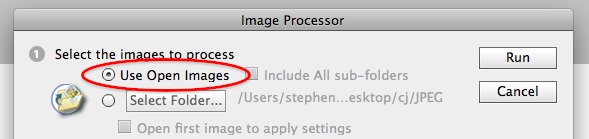

In image processor, do you have the option selected to "use open images"?

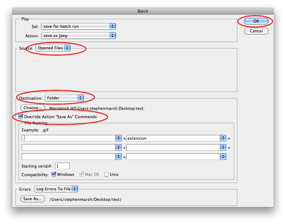

As a last resort, use a batch action to save all open images...
Have an image file open and record an action of the process of saving the file to the required location. Don't worry about the action recording the file name and save path, this can be overridden - all you need to do is capture the file save options. All you need to do is record the save as process.
Then file/automate batch: select the action set and action.
Source: open files
Destination: Folder, select the folder.
Important: TICK THE OVERRIDE ACTION SAVE AS COMMANDS BOX!!!
Select any other options as necessary.
Hit the OK button.
It should be as simple as that!
