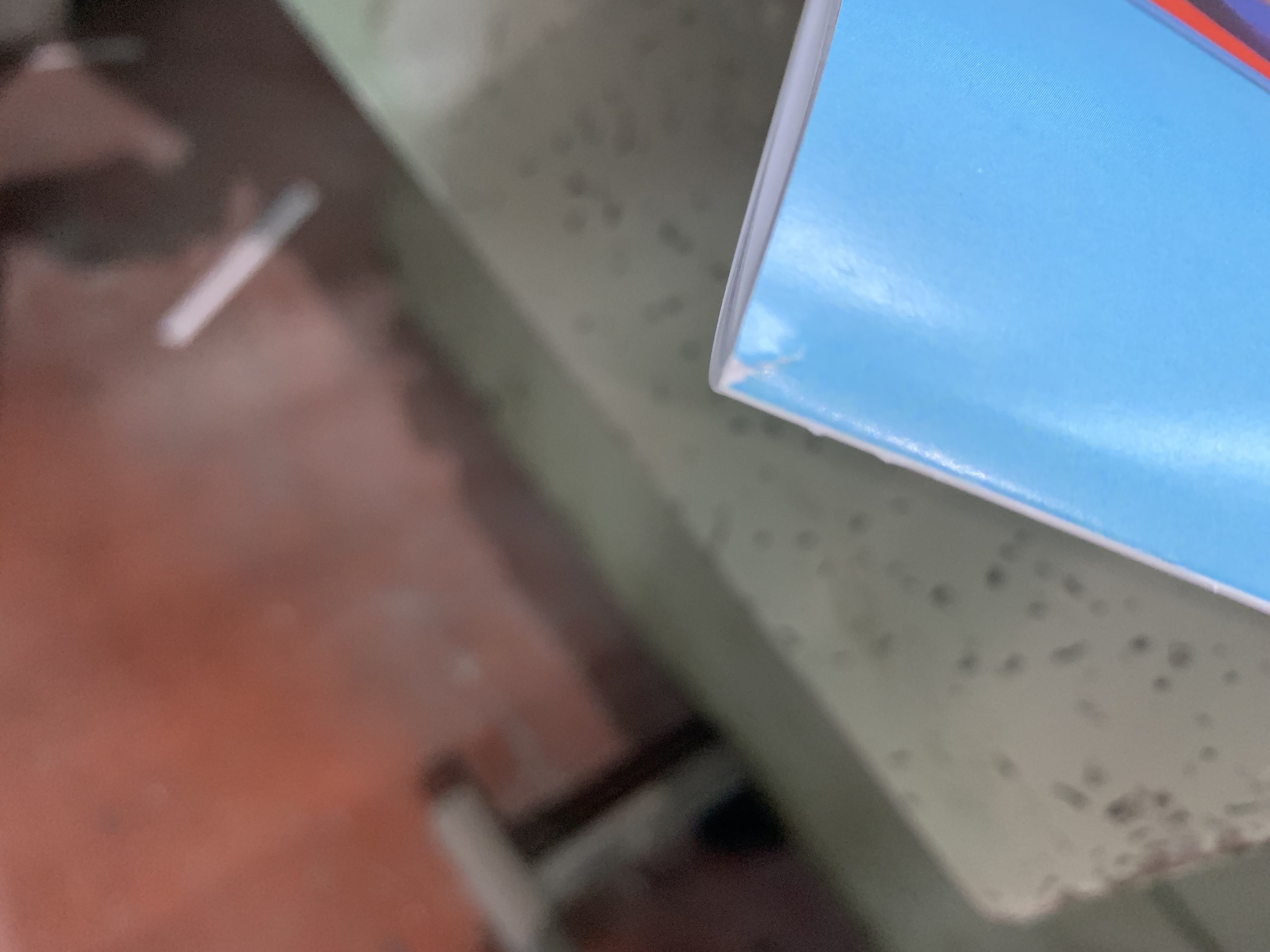

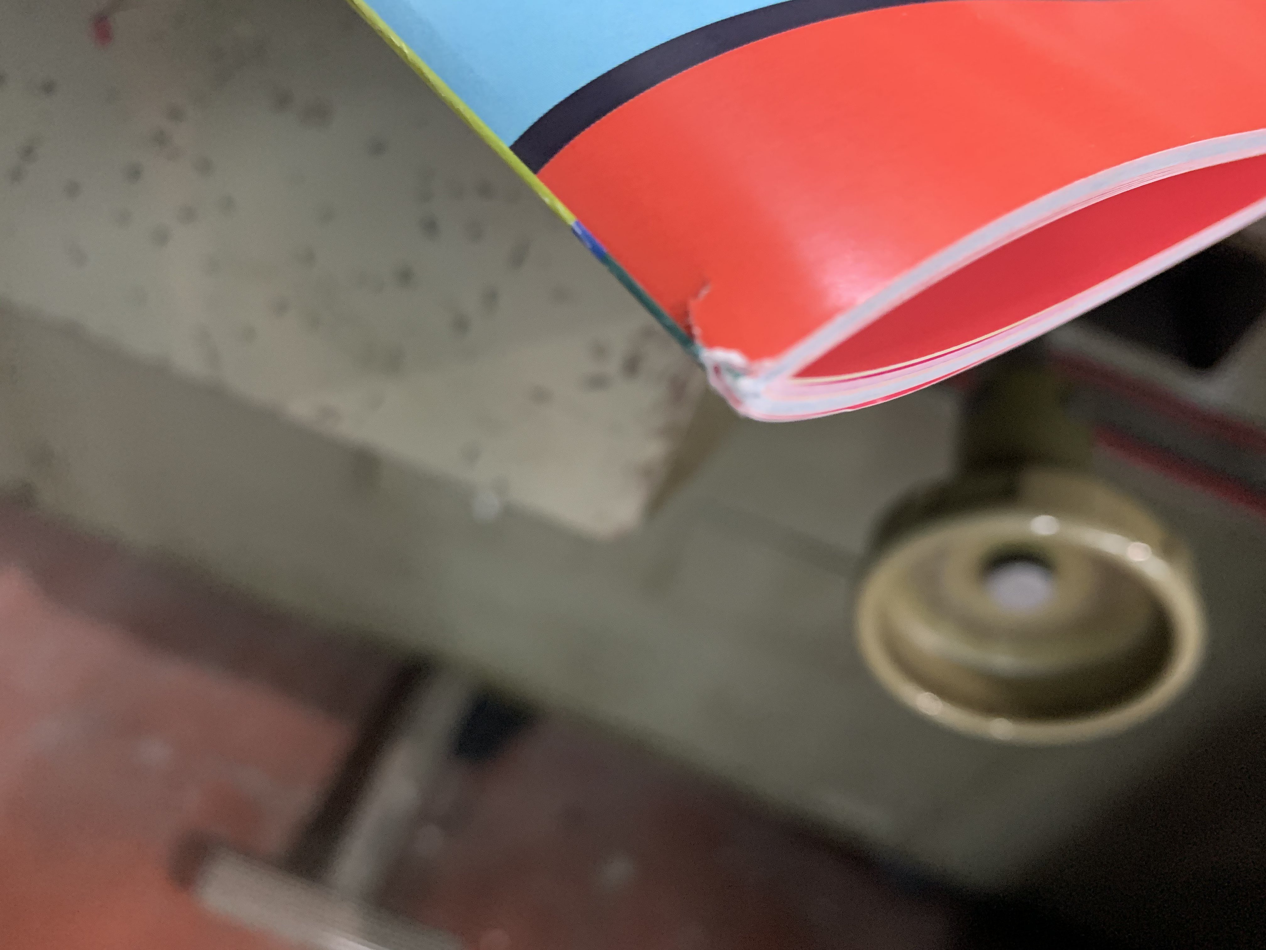

So,
We print lot of books with 100pages sometimes less sometimes more.
we need to cut the book sides after we staple or put glue.
We cut the books with guillotine polar.
The thing is that the books are torn apart at the sides while we cut *include photos*
I cut 1 book at the time. The books are with laminate. also without it is the same result.
Do you have any advice what i can do? thank you.
Gal.

Couple thoughts. Make sure the blade is sharp. Try turning the books so the spine is facing the opposite direction in the cutter. Also check clamp pressure.

Looks like the spine is not opposite to the blade travel direction to me, so it's allowing it to tear. Make sure blade is sharp and the blade travel direction is towards the spine.

The knife is brand new polar sharp knife i use for the books.
i try both sides of the spine to cut and the book still wrap.

Is the tearing occurring on the top or bottom side of the book you are cutting? I would guess it's the bottom.
Both.
I should have been more specific maybe. To be clear, what I was asking was is the tearing happening on the side of the book that is against the cutter table or clamp?

You say you cut 1 at a time. What happens when you cut 2 or more at a time? Do all the books in the stack tear?

About the books cut when i cut 2 or more even 10 it still cuts the corner.
what i found the last day that when i make booklet with square spine the spine dont break and more easy to cut.
