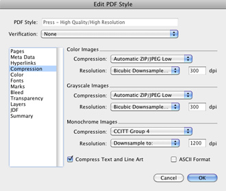

Not sure about Q8, but here's a screenshot of Q9's default Press settings. The compression is Low, which in Quark's lingo means the quality is high.

Interesting. You are right, the "High" in Quark terms actually created a lower quality PDF than the "Low". So, my initial rant was inaccurate. So, I guess it is just JPG compression, in general, that's the issue. Generally, I use ZIP or no compression at all.
Still odd, though. Even with the compression being Low, as in low amount of compression. The printed sheets looked noticeably bad and we rejected the run (at our cost).

Now I'm more confused. Looking at Quark 8's compression settings I noticed that ZIP/JPG are lumped together, whereas InDesign gives you the option to choose ZIP or JPG. Does Quark determine which compression method to use based on some criteria?
I went back and experimented a bit with Quark's export options. There was a big difference between their Automatic ZIP/JPG Low versus their Manual Zip 8-bit.
The manual zip method compressed an image to 44.36% of it's original size. The Automatic ZIP/JPG compressed the same image to 11.78% of it's original size, and there was noticeable quality loss. The Zip filesize was 4x bigger than the ZIP/JPG.
