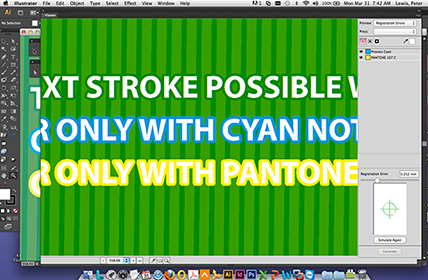

Please see the attached screenshot.
Using Esko's Viewer for Adobe Illustrator plugin and it's registration view feature to shift the colour plates you can easily see the results of the current layout should you have mis-registration on press. Great way to check if you need trapping or not.
You can download a free trial copy here ---> Free Trial software - Esko
