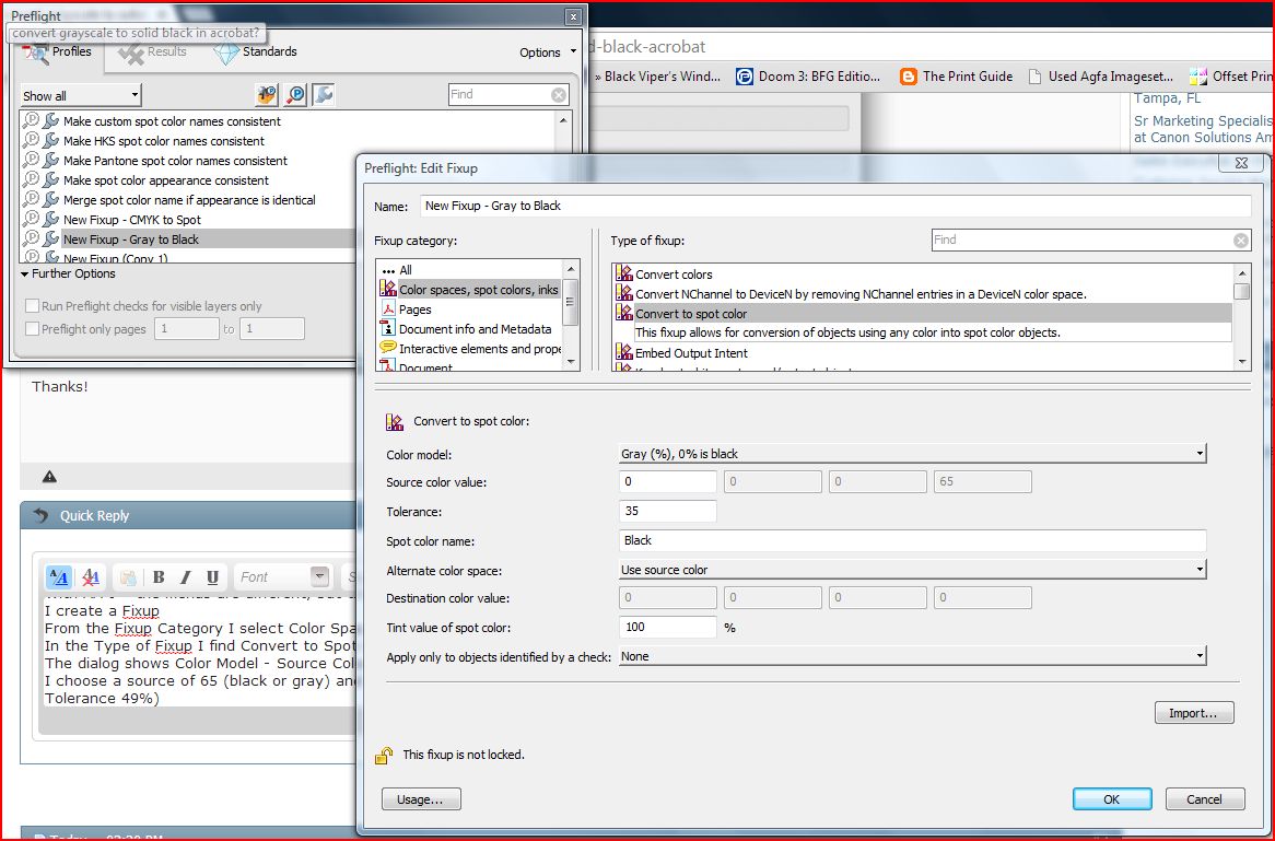

With AA 9 - the menus are different, but the idea is the same.
I create a Fixup
From the Fixup Category I select Color Spaces, Spot Colors, inks
In the Type of Fixup I find Convert to Spot Color
The dialog shows Color Model - Source Color Value - Tolerance
I choose a source of 65 (black or gray) and tolerance of 34. Anything up to 31%-99% black will be changed. (You could choose Source 50%; Tolerance 49%)
Spot color to convert to > Black, 100%
Save and run the fixup

Wonderings, using the output preview object inspector, the box is confirmed to be in CMYK format 60% K. Using the CMYK 50%> fix-up profile that I attached to my previous post, the result is 0cmy100k.
