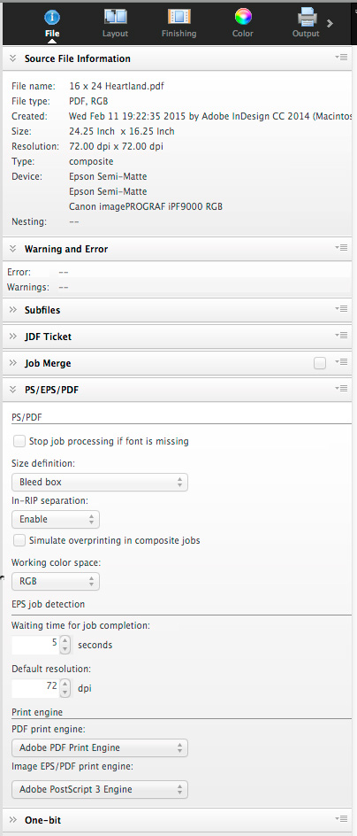

Make sure the RGB driver of your printer is selected in the output device.
Here are the setting you would use. The Fiery XF will then send native RGB to the Epson 9900 just like you OS level printer driver does. In fact you can use RGB Profile Connector to install your printer drivers RGB profiles for Fiery XF to use, or new RGB profiles you have created.
