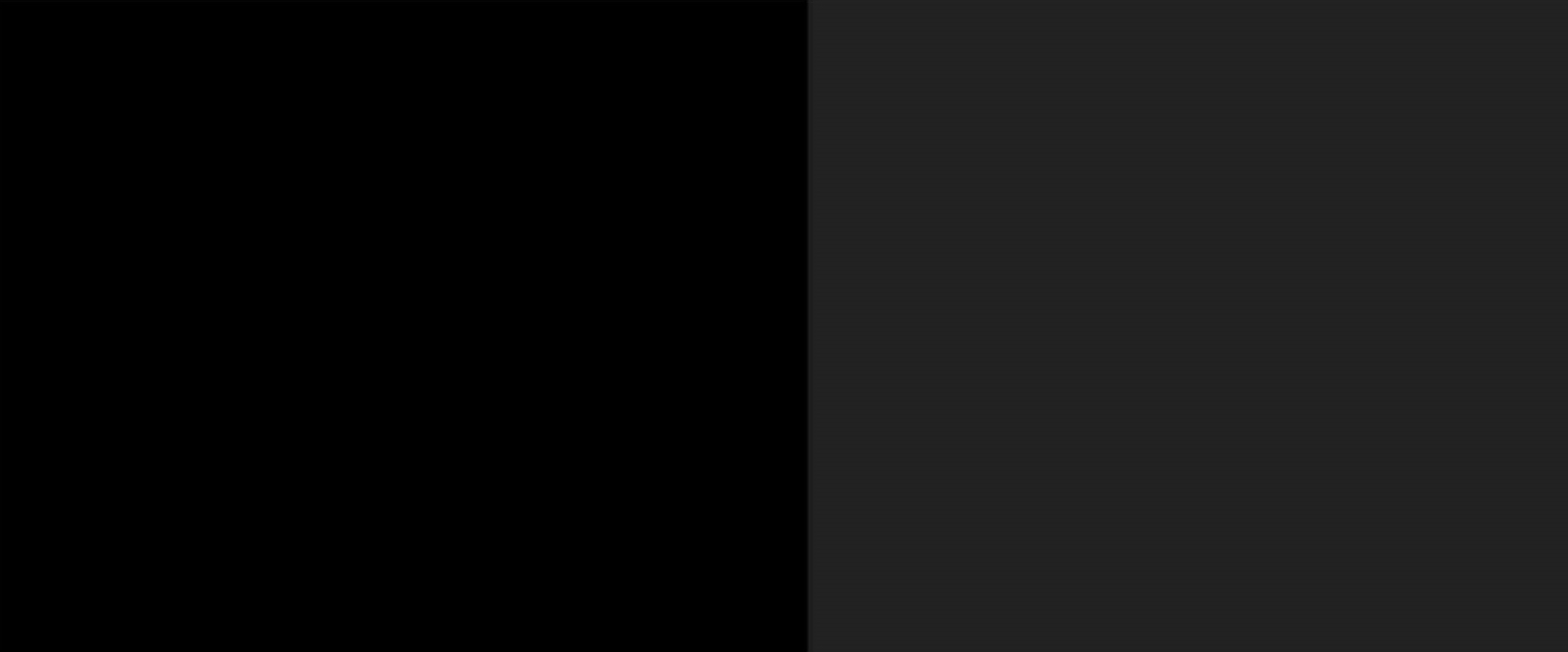

This is a simplified example of the difference between RGB black (left) and CMYK black (right).
Instead of rectangles, it can be a b/w photo of a person or anything, but the effect will still be (more or less) noticeable.
There is no black in RGB, if you are supplying files in an RGB colourspace with blacks defined as 0R:0G:0B, you will end up with a rich black depending on GCR/UCR in the profiles used to convert to CMYK.

The only thing I can offer is this rough simulation that I made in Photoshop. If this is a court, this is how I would describe the event.
Please download the image if you need to zoom in. This image is not from my actual work. I just picked it up online to use it for this example.
