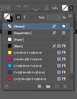

LOL - I was just pointing out that in InDesign those are the two "default" black options. Maybe the offset printers should make a coalition and talk to Adobe about not making those the two "black options"
No there are not 2 default black options, there is black and there is registration, which is clearly labelled as registration. If users select this swatch for printed elements, it's not Adobe's fault, it's users creating content for print who don't understand the print process.
InDesign gives these options in the "default" color swatches window. There's clearly two options for black, one produces a nice rich black and the other produces a flat black.
Expecting anyone beyond "sophisticated" users to know they need to custom mix a black color for offset printing use is unrealistic.
