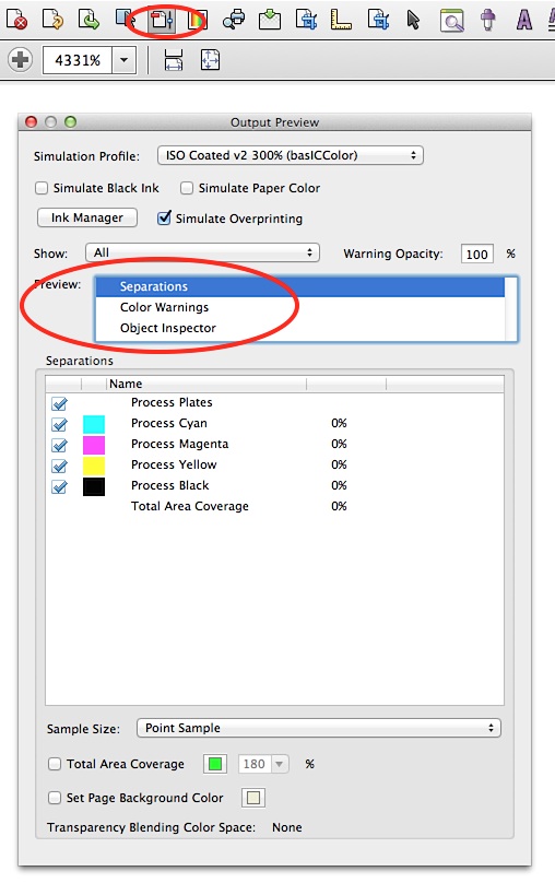

This is most helpful. I was always told to use the eyedropper tool that lies under the "Inspector" category in Acrobat. Can you tell me where to find the "ink coverage" and "basic object" options? (So sorry, I'm very green when it comes to prepress, obviously LOL.)
Stephen Marsh
The Print Production Tools Output Preview window has different features depending on the version of Acrobat Pro.
The attached screen capture is taken from Acrobat X.

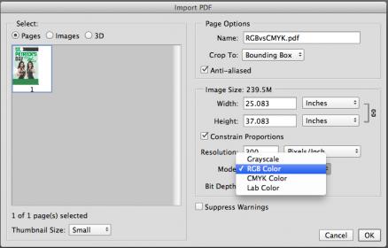

So uh this file you uploaded is that the file you printed from? Cause I see absolutely no RGB in there what so ever. What are you using to print? What RIP are you using?
According to Acrobat is was made in Illy CC 14 (Mac). Checked in il was all CMYK, I ripped it in our rip (Rampage) No RGB errors came up, callouts of green bar at bottom match in Rampage AND Acrobrat.
Are you sure when you "imported" it into Photoshop you forgot to change RGB to cmyk? see photo --> Screen Shot 2015-04-14 at 4.55.42 PM.jpg
But everything looks CMYK to me if that is indeed the Original file they sent you.

In your original PDF, open Output Preview and set the "Show" menu in the Output Preview pane to RGB and if everything disappears there is no RGB.
