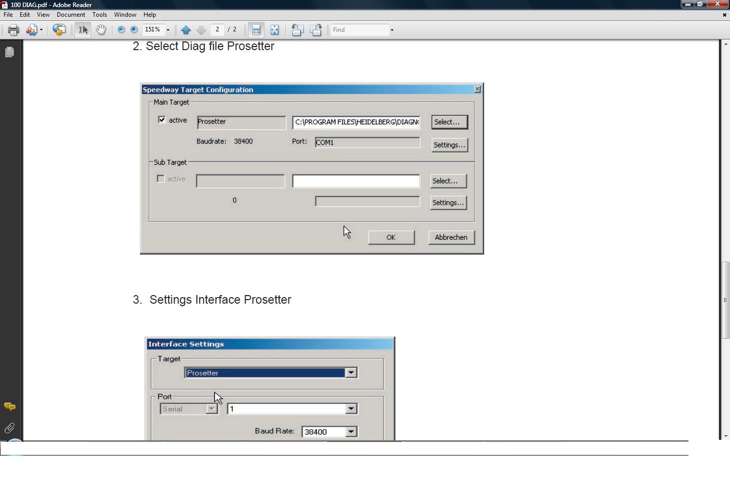

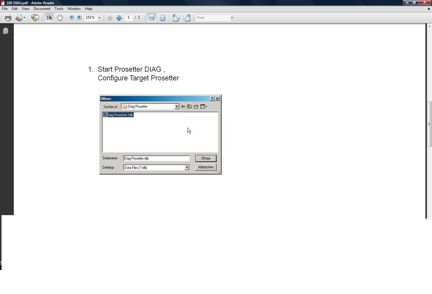

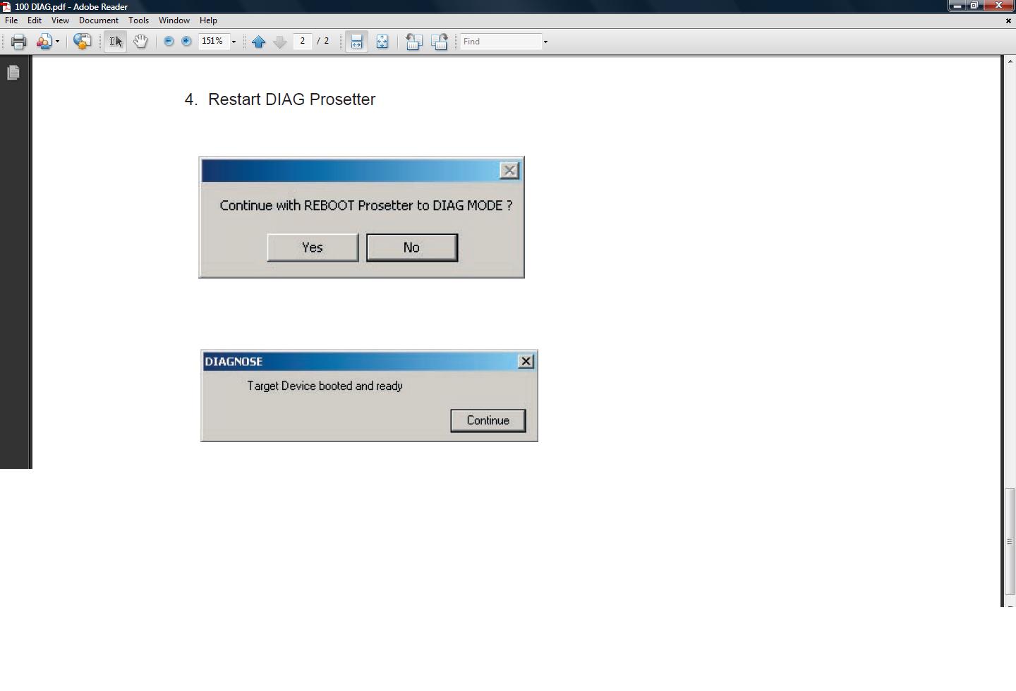

Finally, can't boot prosetter in Diag mode:
1) Please close the GUI before start the Diag software.
2) Please follow the step as per attached file.
Hope this can help you. Anyway if you need Prosetter parts, you can contact me.
