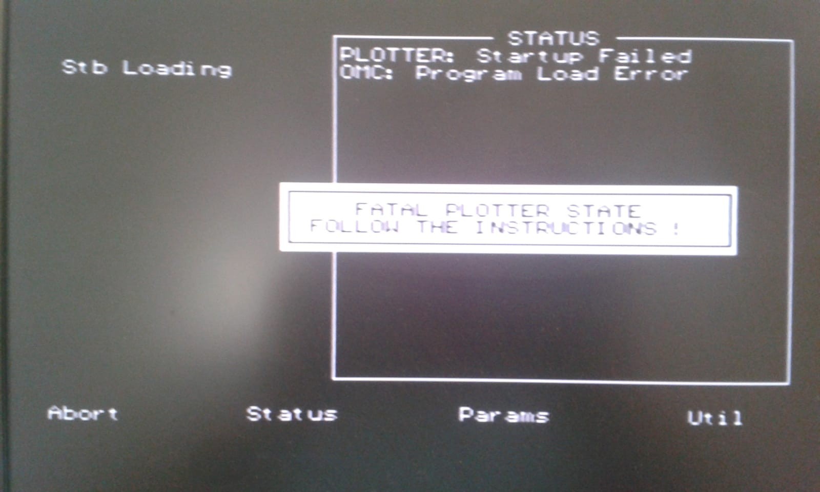

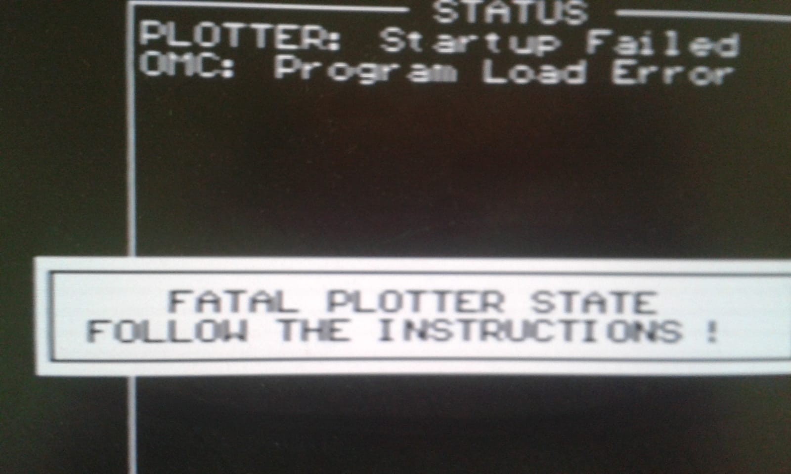

Hello,
The machine is booting up
OMC: Program Load Error.
I'm glad you helped me.
Thank you...

Repro_Pro
Try cleaning and re-seating the Strobe and OMC boards.
If this doesn't help try replacing each board with another board that is known to be good.

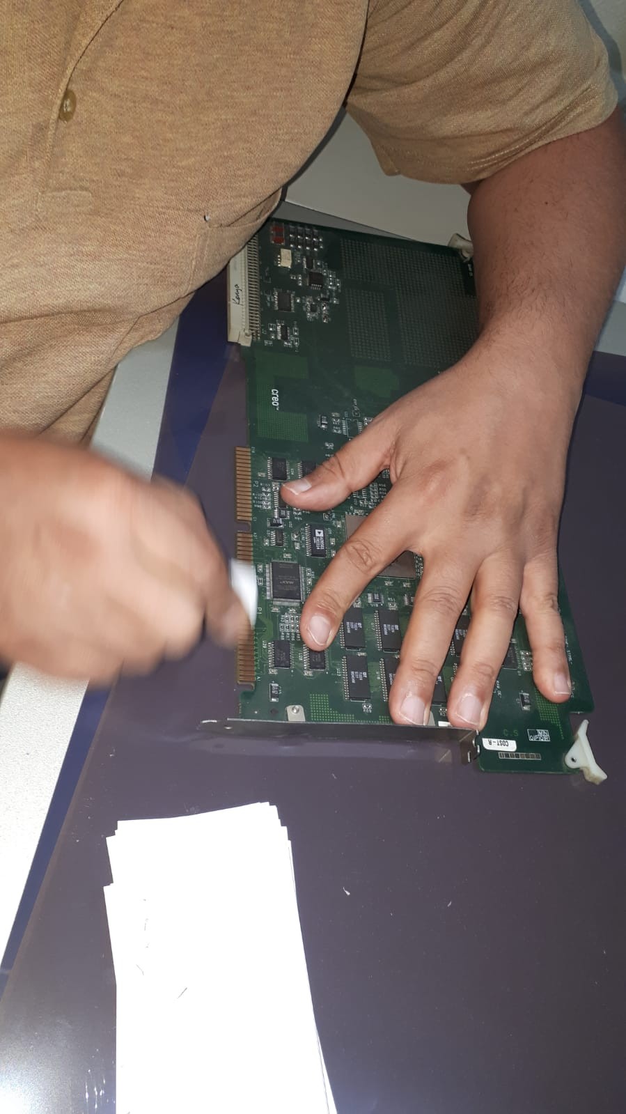

Blowing away dust is not enough.
The gold plated contacts on the boards are frequently a point of failure.
Clean the contacts on both sides carefully with alcohol and than with a pencil eraser (its' actually a very light polishing job).

I cleaned it with an eraser. The error did not change. Do you have any other suggestions?

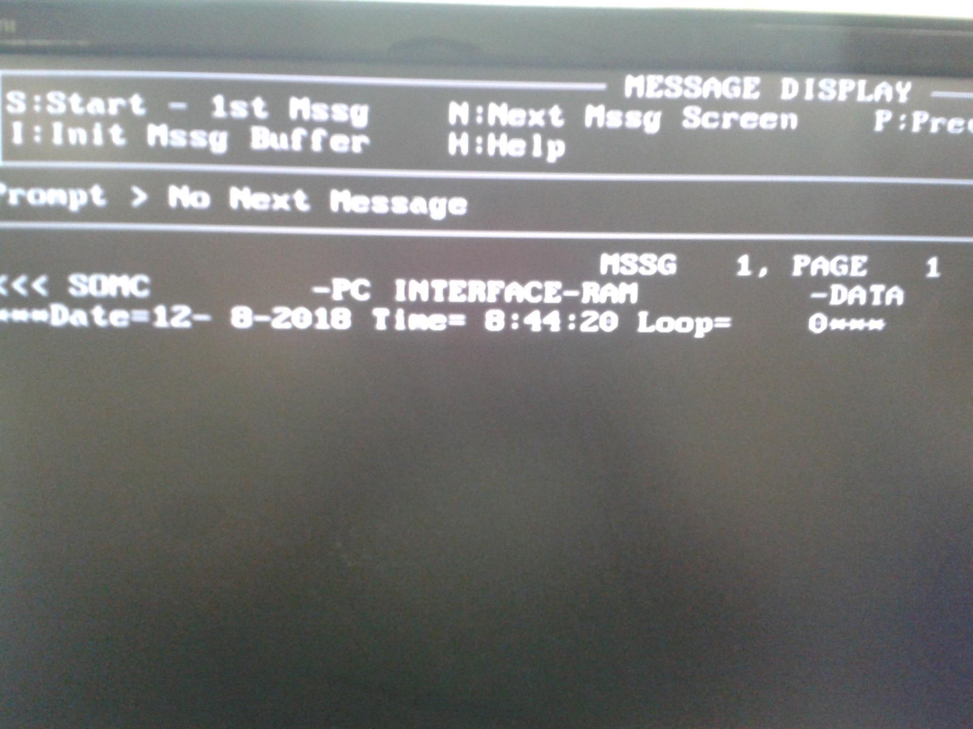

Repro_Pro
Check for the error message using the "Show Errors" function and act according to the relevant error.
To access the "Show Errors" function:
a. Pressing F1 (until) on the operating panel
b. Select "Show Errors" using the arrow
c. Press <Enter>.
NOTE: Return to "Standby" by Pressing <Esc> twice.
If there is no help there, you'll need to replace the OMC board.

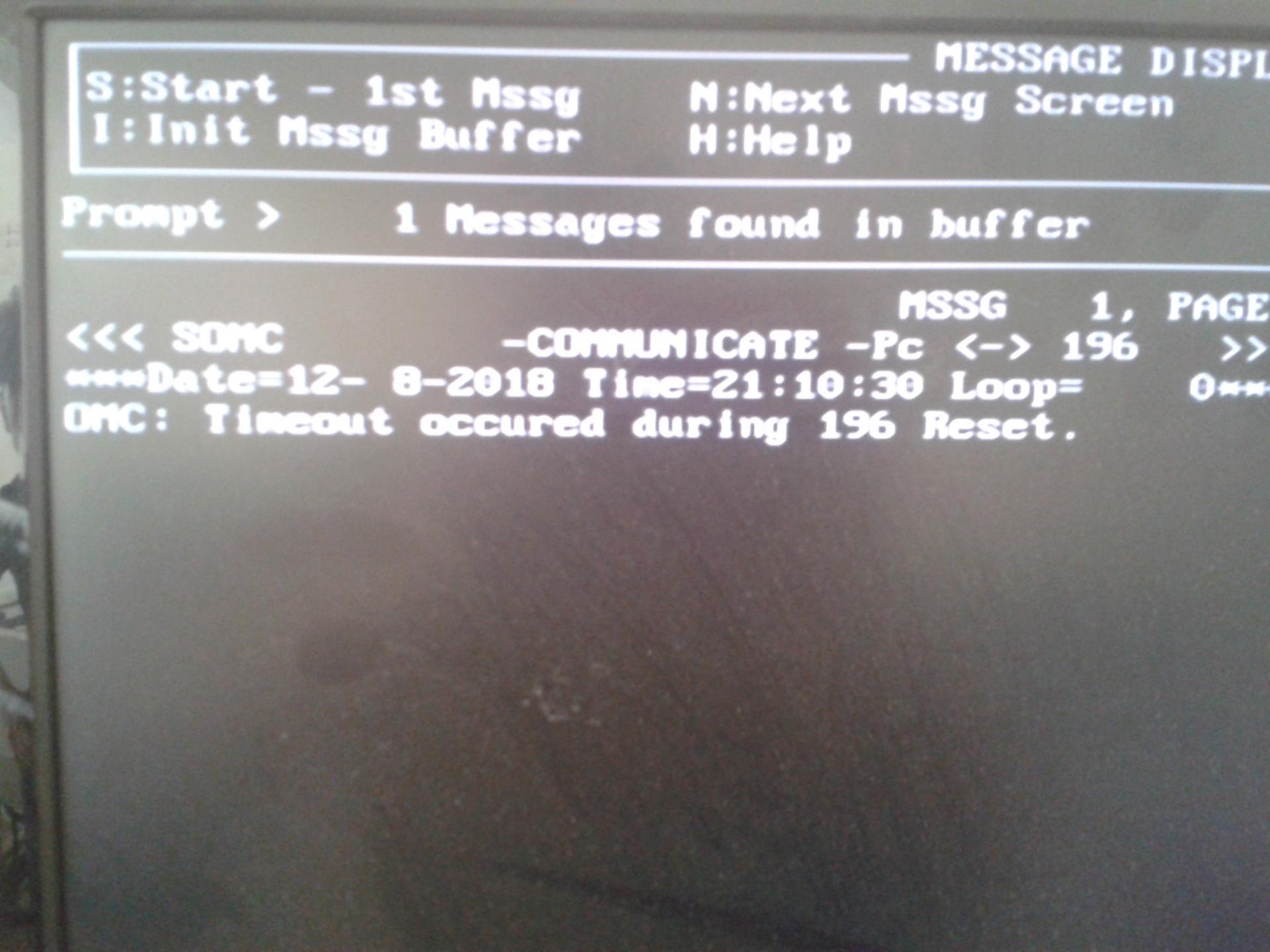

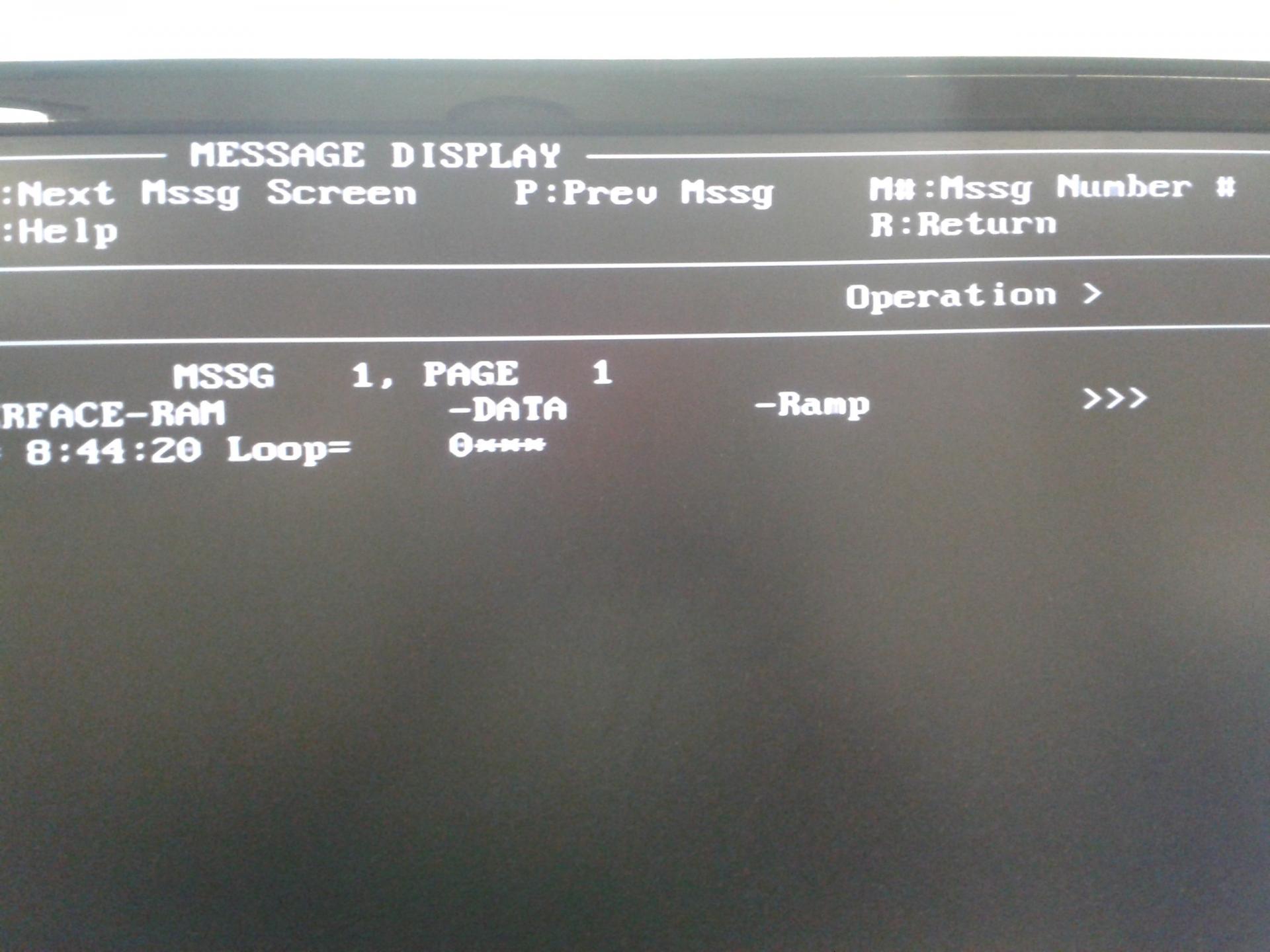

abort-status-parms-util does not work because I am not in standby, but I will try again. Any other suggestions?
NOTE: I can not intervene because there is no fatal error.

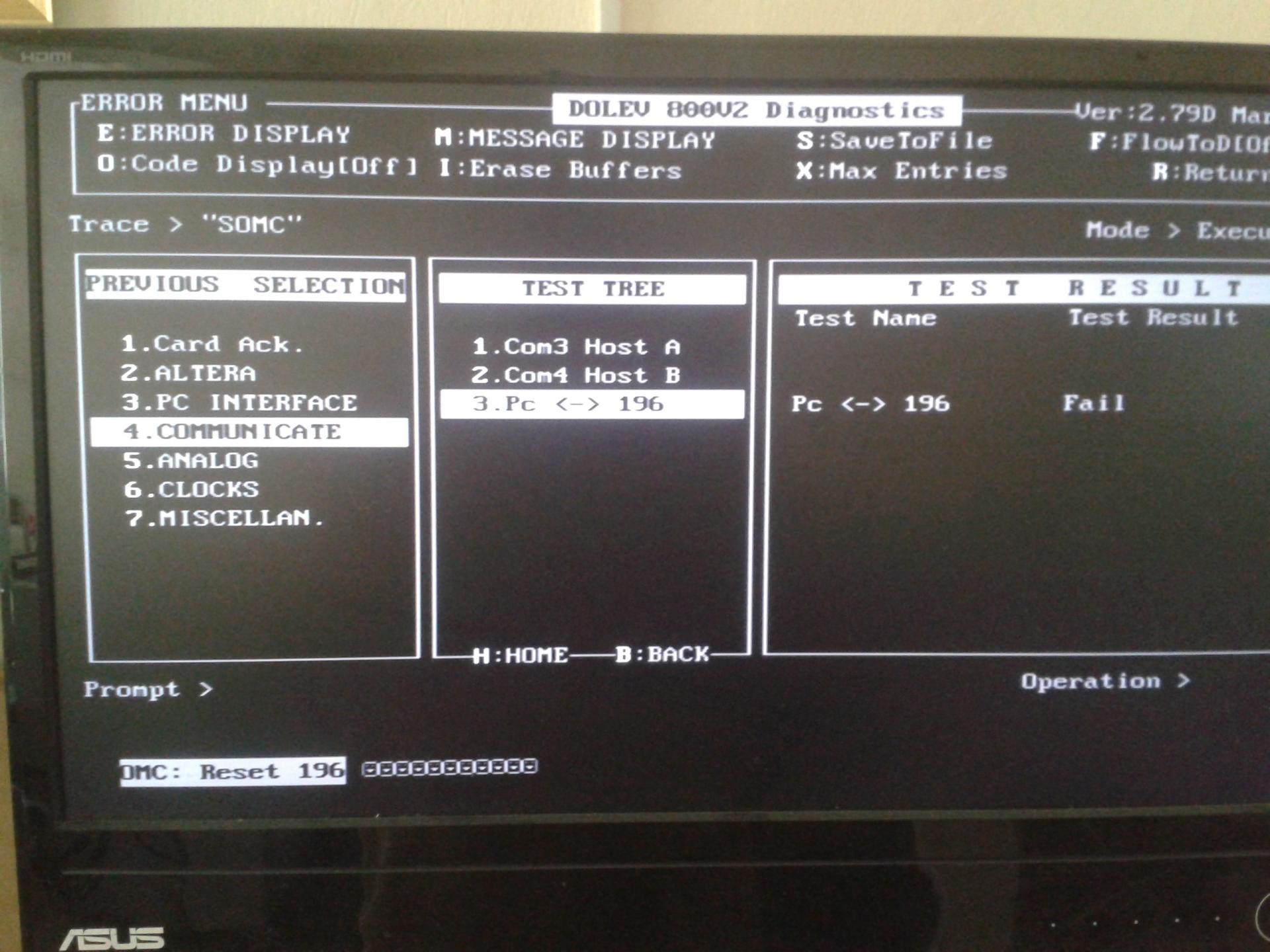

Repro_Pro
You may use the Diagnostics Program to help.
On your Dolev 800V2 it should be installed and accessible under "Utillities" or you can operate it from the diskette.

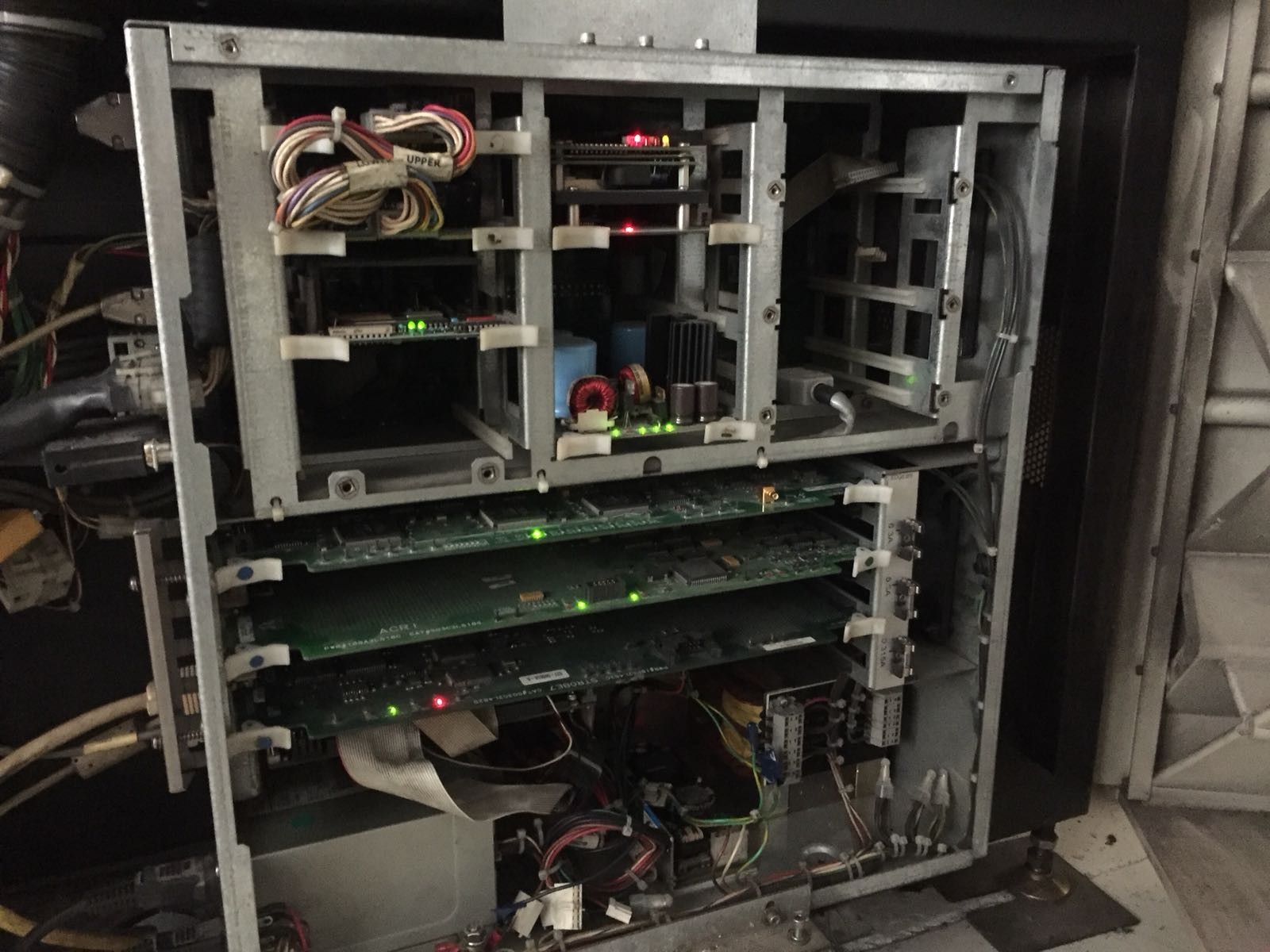

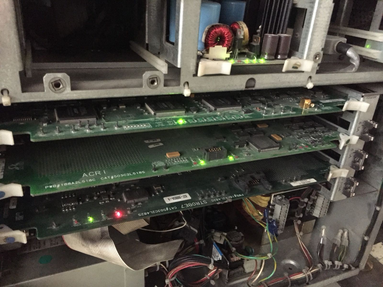

Thank you Scotts, but I cleaned my card and even cleaned it with the Electronics Technician, but there was no solution. Dolev is still not open. Electronics technician says no fault. I was desperate.

scotts
It's been a long time since I worked with a Dolev 800, but normal issues I would look for is, wires that are not making good connections or a not connected. DO NOT just go plugging in cables that are not plugged in currently unless you KNOW they are supposed to be plugged in. Then also look for wires/cables that are damaged/worn. With age comes time to replace some worn items, even though they don't technically get "used" or moved around much. Just do a really good look over. Maybe you will get lucky.

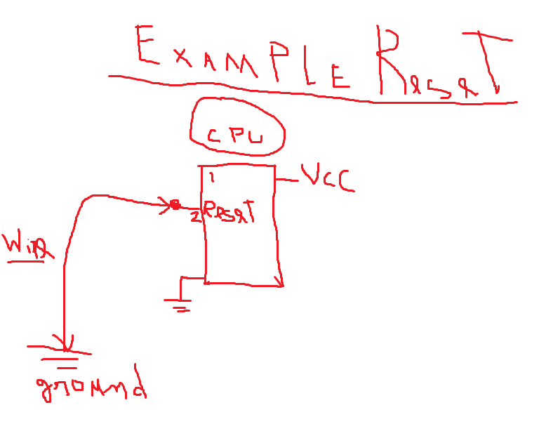

6)Reset CPU:
reset cpu see the attached schematic.
Let me know

Dear chock Thank you for your interest. But I'm not a technician, my user. I've done cleaning and checking as much as I can. The result has not changed. But I did not understand the RESET phenomenon. Can you give a little more detail?
