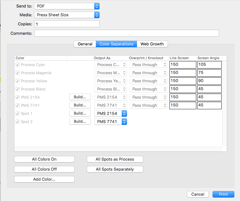

If you are "printing" from Preps make sure the PDF Color Mapping button is selected (under the General tab of the print dialog.) Then under the Color Separations tab you can map the color bars to the desired spot colors used in the art. This only works if the color bar you are using has spot colors as well.
