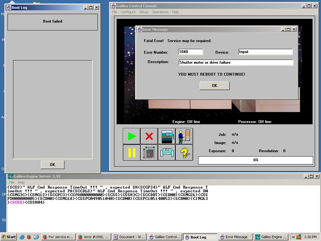

ow are you?, i don´t know if you can help me, i turned on the galileo, and i waited for all the systems to work, and once they did, i wanted to refill the plates, so i sent the command "move bins to loading door",but once i did, a message appeared, displaying an error number: 1040, "shutter motor or drive failure", i don´t know if i did something wrong, can you help me with this?, i would really appreciate it, thanks a lot, best regards!!!!

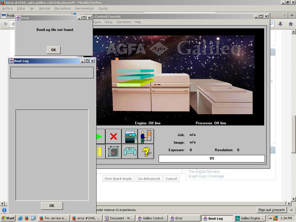

sure, here they are,
thank you for all!!!!
best regards

I see :)
That means your Galileo did not boot at all!
You have to open the Galileo door (or cover) from the Service side (where all cables are connected), remove the black safety locker and insert it into the red safety switch.
Turn the power ON the Galileo and tell me - do you see red LEDs lit on the SSDM modules (two big plates with lots of cables connected) which installed vertically inside the machine at left and right sides?
And give me all other answers in Private Messages because there are very specific questions and not for every forum visitor.
Thanks
