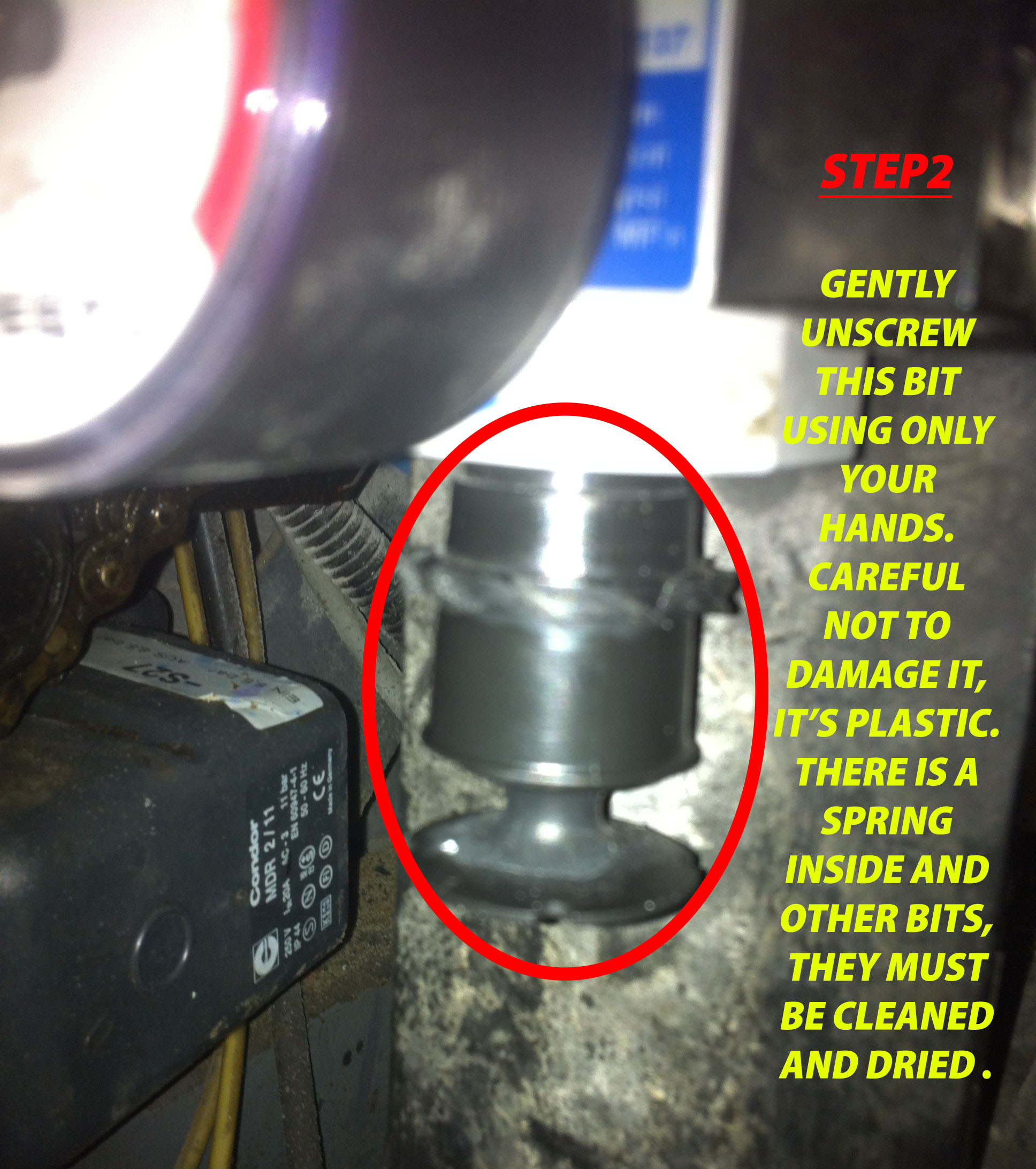

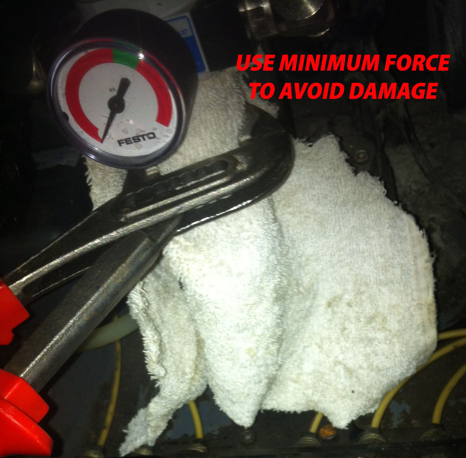

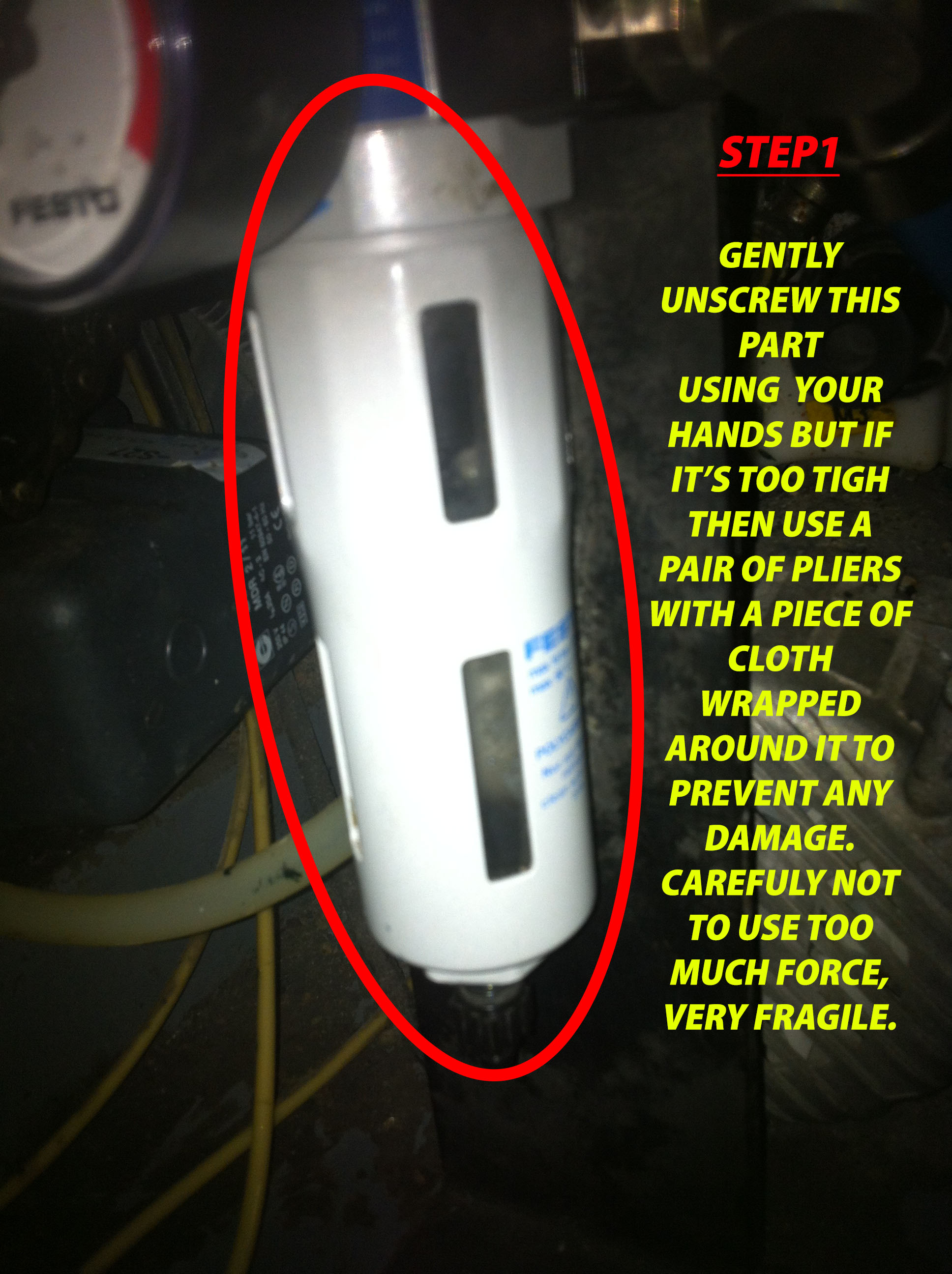

The issue was on the gauge itself. It's the safety valve which was blocked because of dirt building up inside. That explains the air escaping from the top of the gauge. The spring which turns on & off the safety valve was stuck in one position.
We had to open it all up and clean the inside bits. It was full of lime scale and dirt after so many years of use.
I have attached pictures for the procedure, hopefully this will help somebody out there.
All the best and thank you all for your help.

Well done sir. Congratulations on resolving the issue. Who finally nailed the problem? I know that these units should be constantly monitored and drained. I have heard of operators opening the valve as part of shut down procedures daily. The constant air escaping when you fire the press up in the morning will serve as a reminder to close the valve. This is a similar situation that should performed on the SM52 to get the Dampening system to release the metering roller from the pan roller. I believe that if you do it on a consistent basis the valve can be released with just your fingers. I commend you on the rag with channel locks approach.:)
