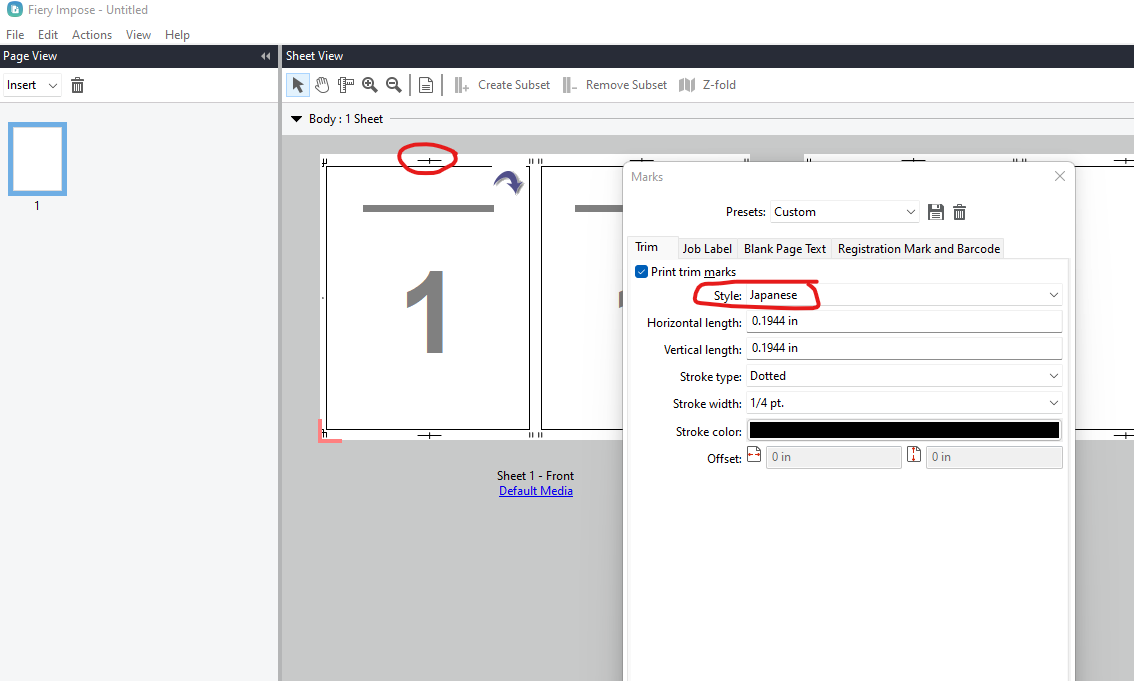

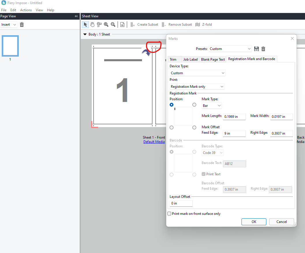

Do you mean, center of the card or center of the sheet itself?
Technically you can trick it into putting a mark in the center of the sheet if you wanted to by using the custom registration marks settings, it'll only do one though at the top. I've attached a screenshot.
You can get center marks on your card by switching the type of crop mark to Japanese.

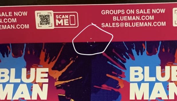

Thanks for both of your replies! Here are examples of how we like to have our marks via Illustrator. It's much easier to visualize and cut so that all of our pieces are uniform. We're a super short-run shop, so we have to deal with a lot of garbage files with no bleed and not much safety margin, so sometimes its helpful to make cuts in different orders, and center marks make it easier to visualize gutters so that all of our prints have equal margins.
For us, center marks are the most helpful when trimming 24-up business cards. We can get by on 6-up and 9-up w/out the center marks, but it would be nice to have consistency for all of our marks. It doesn't look like there is a way to produce this via Impose. It's not the end of the world, it's just another step.
Examples

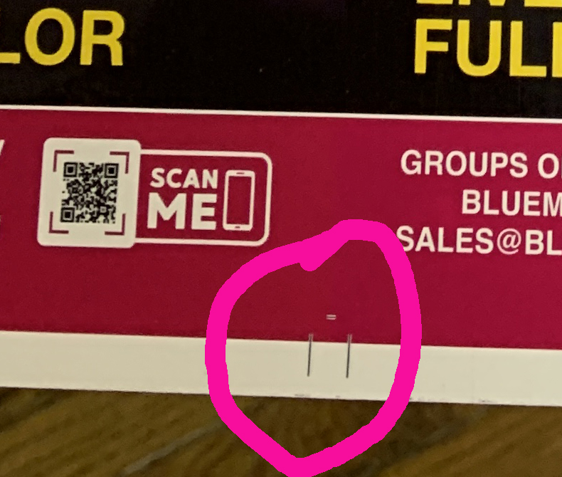

on your blue man group image, are the trim marks there what you've added in illustrator? Are these the centre marks you mean?
pippip
You can get those marks through impose.
In Impose (assuming an import of single A5 to be laid 4up)
Set trim marks to 2mm and gutters to 5+mm and those will appear. Sheet Size SRA3.
You'd want to have bleed set to 2mm and finish size A5 with maybe a custom zoom if no bleed was originally present.
