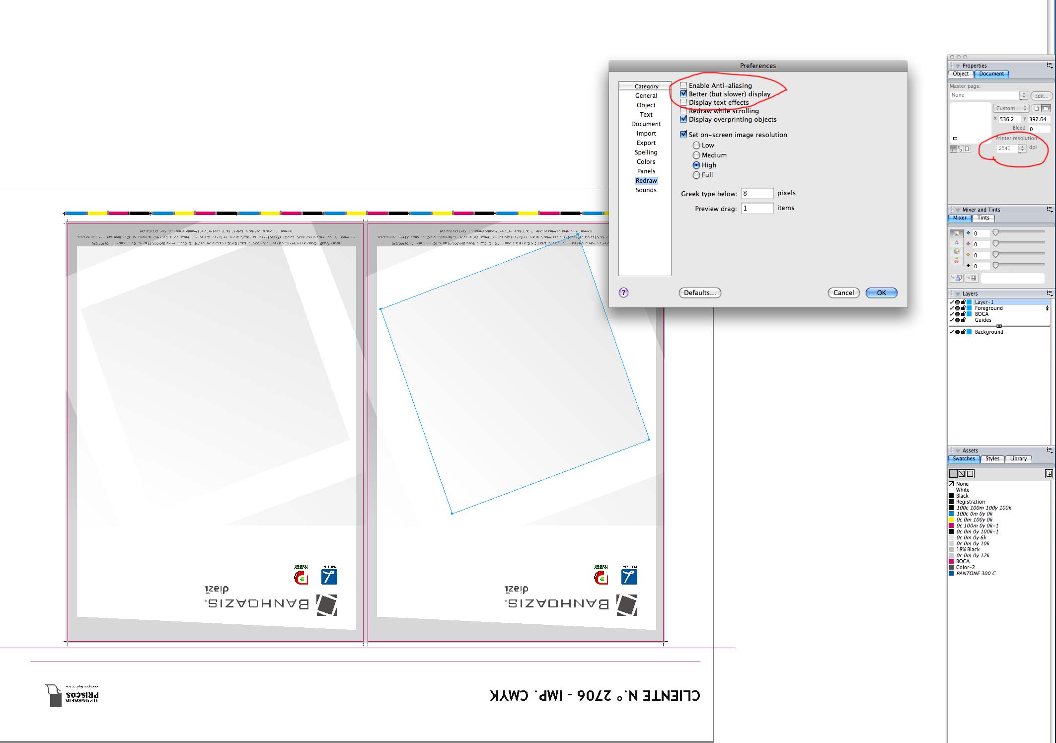

Hi
You can see in the picture attached to the solution.

@yavo interesting that the angle of the banding shifts between left and right image. (but there is banding in both) Adding noise to a gradient produces similar result as hybrid raster.
