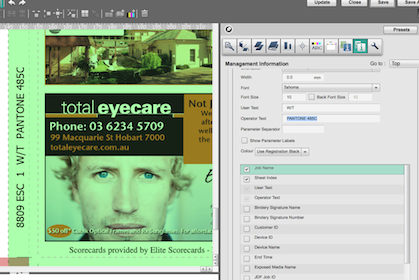

Hi Matt, There is currently no way of mapping black to a spot colour in XMF. However I have got around the issue of the plate label. In the management info or slugline (depending which one you use. I use management info personally) Uncheck the separation box and add in some operator text. See screenshot attached. Otherwise if this still doesn't go far enough for you I would convert the file in PitStop before dropping it on the rip.
