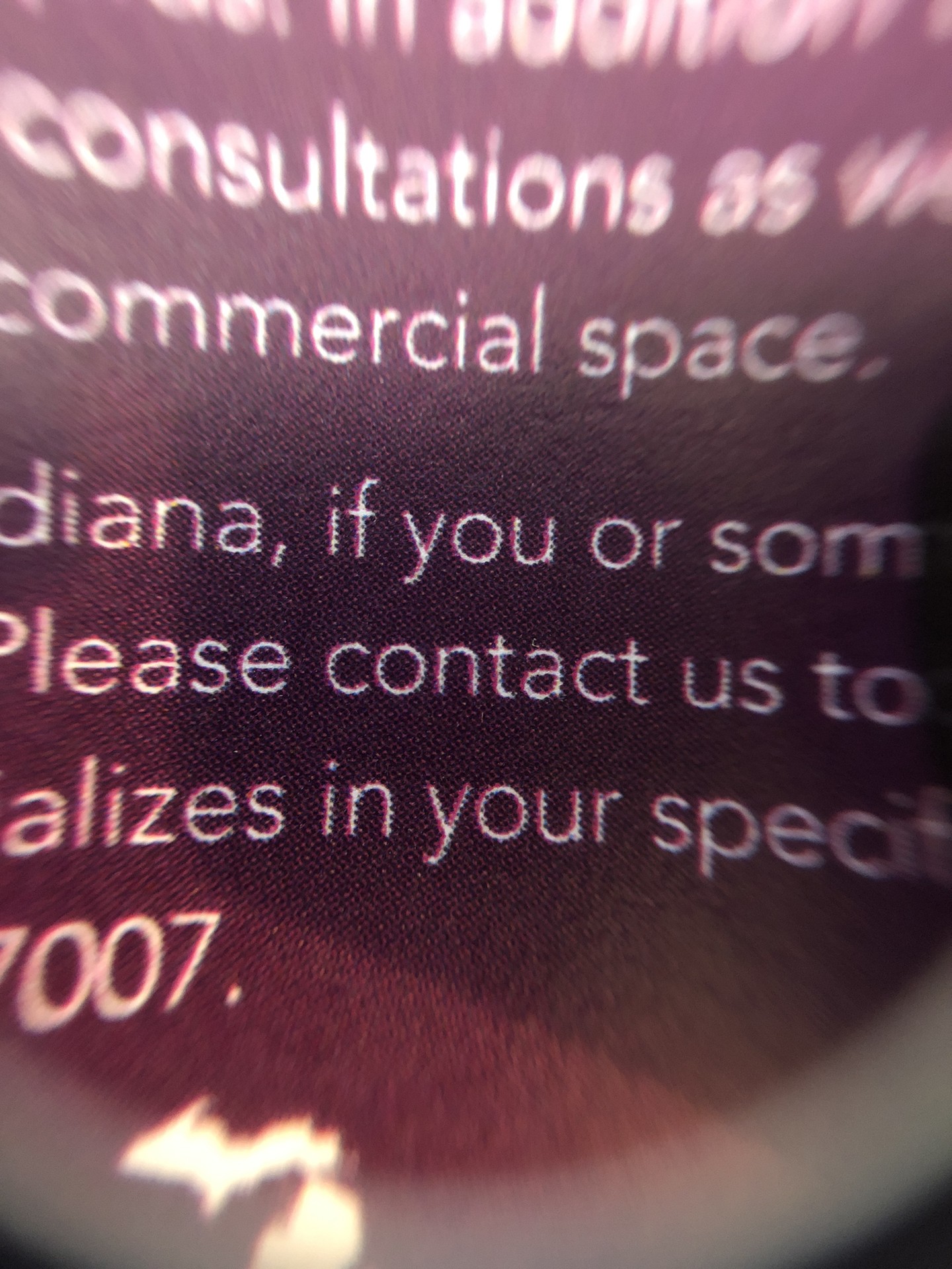

Loupe: I took a picture with my phone through the loupe. Not sure exactly what I'm looking at. Is the cyan out of registration?

From that picture, I'd say maybe magenta is out of register with the others, but kind of hard to say. Something is definitely not lined up quite right though (looking at diagonals, 'y' and 'o'). I'd certainly check that on press (if possible) and maybe try a different screen rotation/setting if that doesn't work. But with that thin font I would give outlining a shot as well. Depends on the client whether it will be acceptable as it does alter the look a bit, making it slightly thicker. Most people wouldn't balk at the thickness though, if they could read the text much better outlined vs live.

This is on a digital press, so I'd call in the tech and show it to him. It looks like what cec-prepress says: out of register.

I think that you may be seeing some artifact of what we call "sawtoothing" when the build of either the type or the background is composed of nothing but screens and none are a 100 color you get the dot pattern that interferes with the "smooth" edges of the font . . the size doesn't help either nor the magenta not hitting correctly
