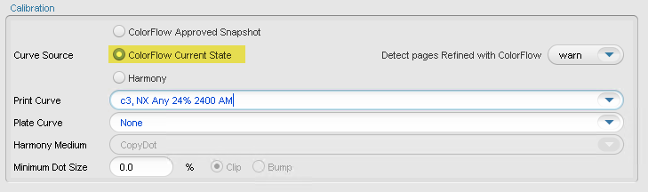

SZmetana
You can continue to use the Harmony to do tonal calibration for Kodak Prinergy, but Kodak recommends you make the switch to ColorFlow. Harmony just does single-channel adjustment of values, it doesn't know anything about the "color" of your presswork. ColorFlow Workflow Edition is included with every Prinergy system and allows you to create gray-balance curves or align to G7 or any of the latest print specifications such as GRACoL and FOGRA. Even if you're not measuring print results and just creating transfer curves (ie. entering a bunch of numbers the platemaking department gave you), ColorFlow has a very simple UI and allows you to copy and paste from a spreadsheet or text file right into ColorFlow. Once in Prinergy, just select ColorFlow as your curve source and select curves as you normally would.
