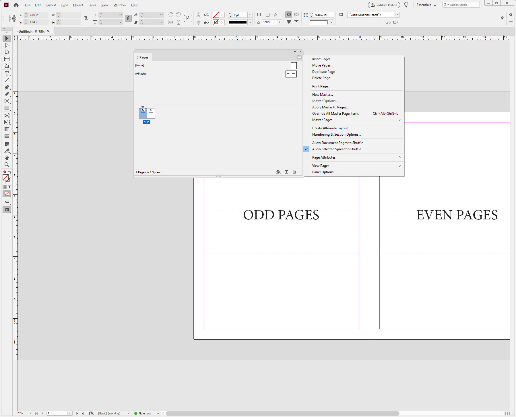

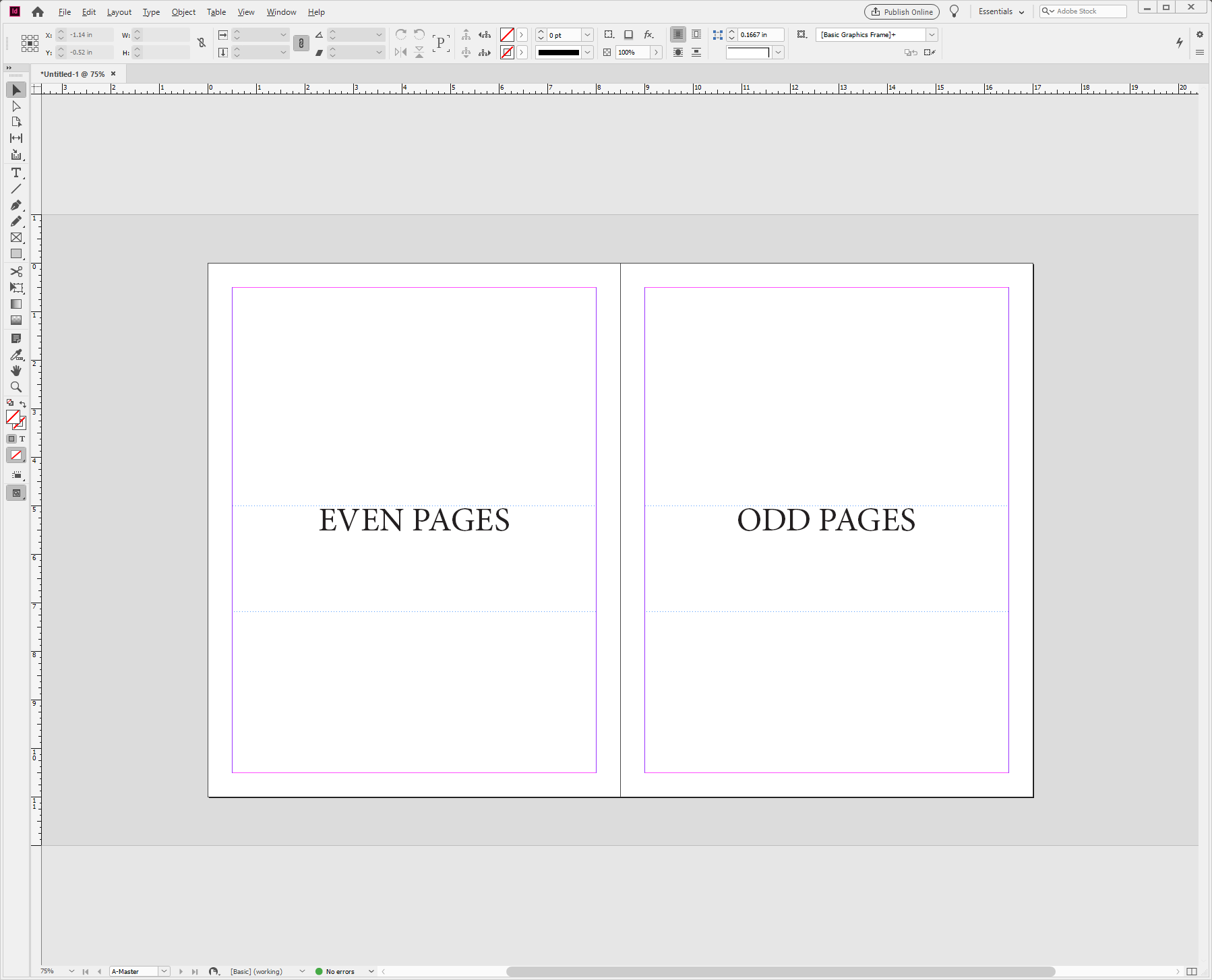

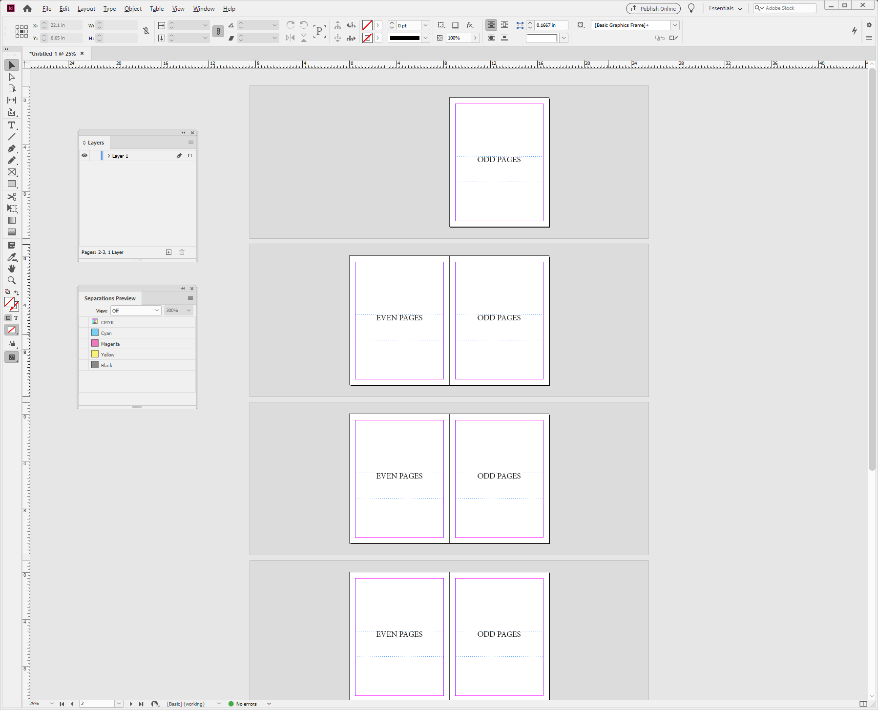

It's all A master. Just make the master page 2 pages - odd on the right, even on the left - and set your pages to facing pages. MasterPageA.png Results.png
You can do it as non-facing pages as well. Make your master with odd on the left and even on the right. In the pages pallet, make sure "Allow Selected Spreads to Shuffle" is checked and "Allow Document Pages to Shuffle" is not checked. Then drag page 2 to the side of page 1 on the pages pallet.
