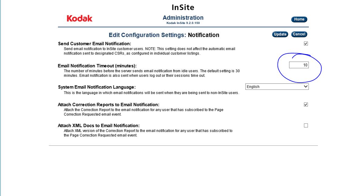

Does anyone know if and how I can spend up the Insite mail delivery meaning when we send a secure link or a approval link it's about 20 minutes before the email shows up.

Try this:
