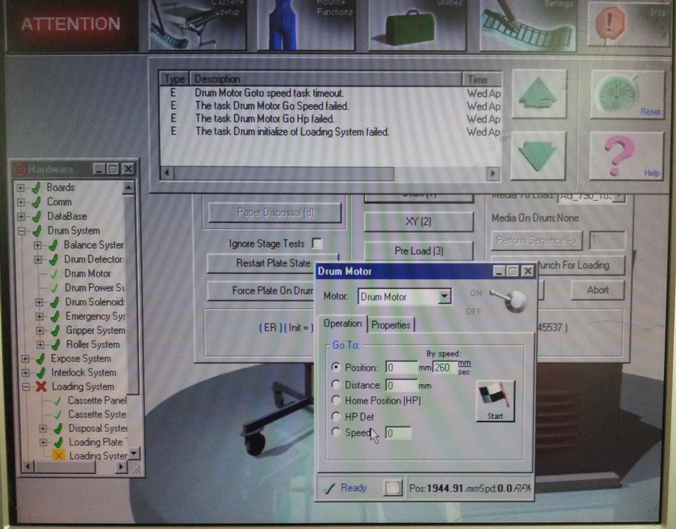

Unfortunately, the replacement failed totally, the drum didn't rotate at all, showing this error screen: Drum_Problem_SCRN_.jpg
Does this mean that the "new" board is faulty?
Any ideas?
TIA
If the Lotem worked before, even with an intermitent problem, it means that the replacement is faulty.
=Repro_Pro;195056]Unfortunately, the replacement failed totally, the drum didn't rotate at all, showing this error screen: View attachment 3422
Any ideas?
TIA[/QUOTE]
