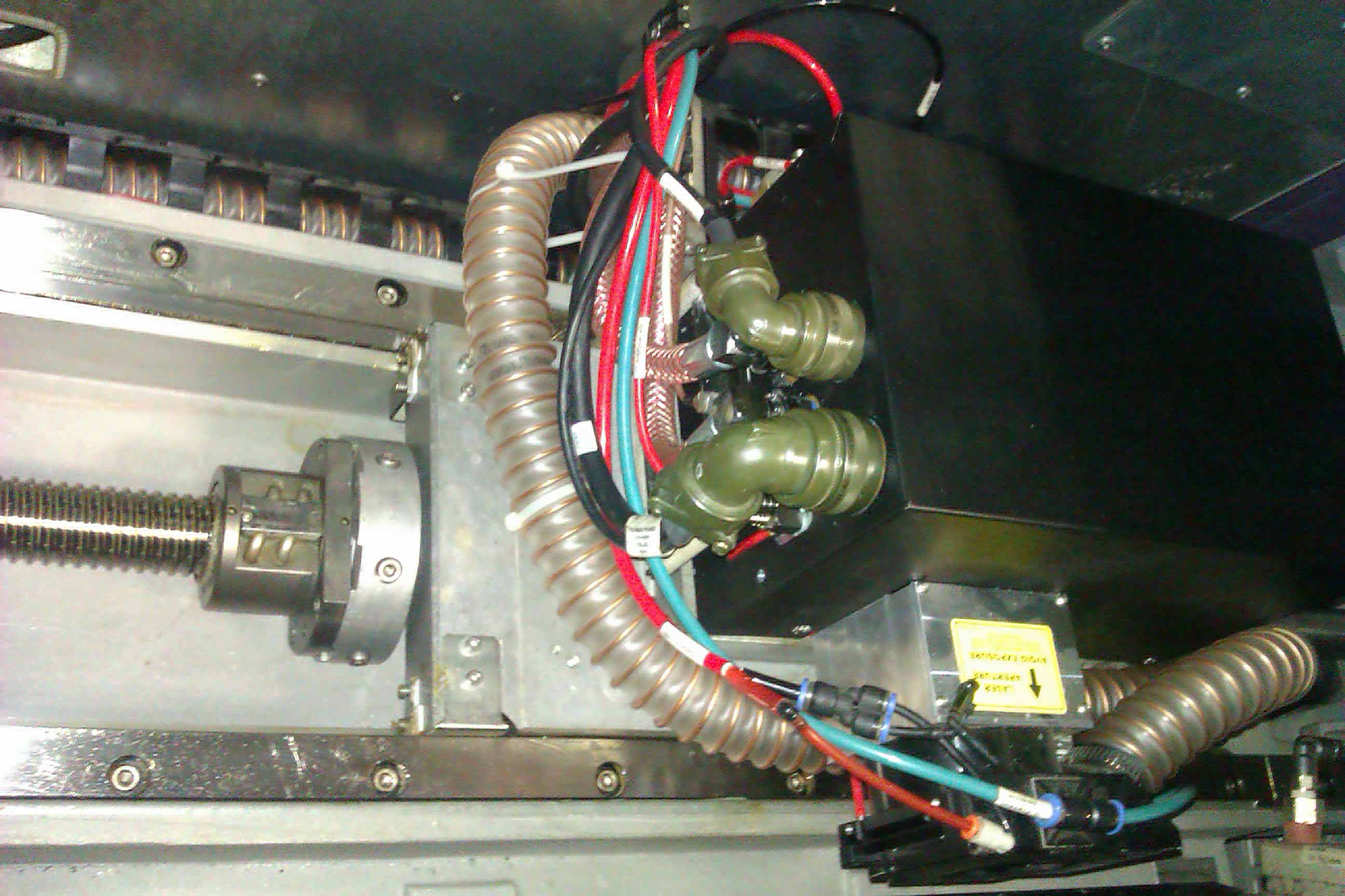

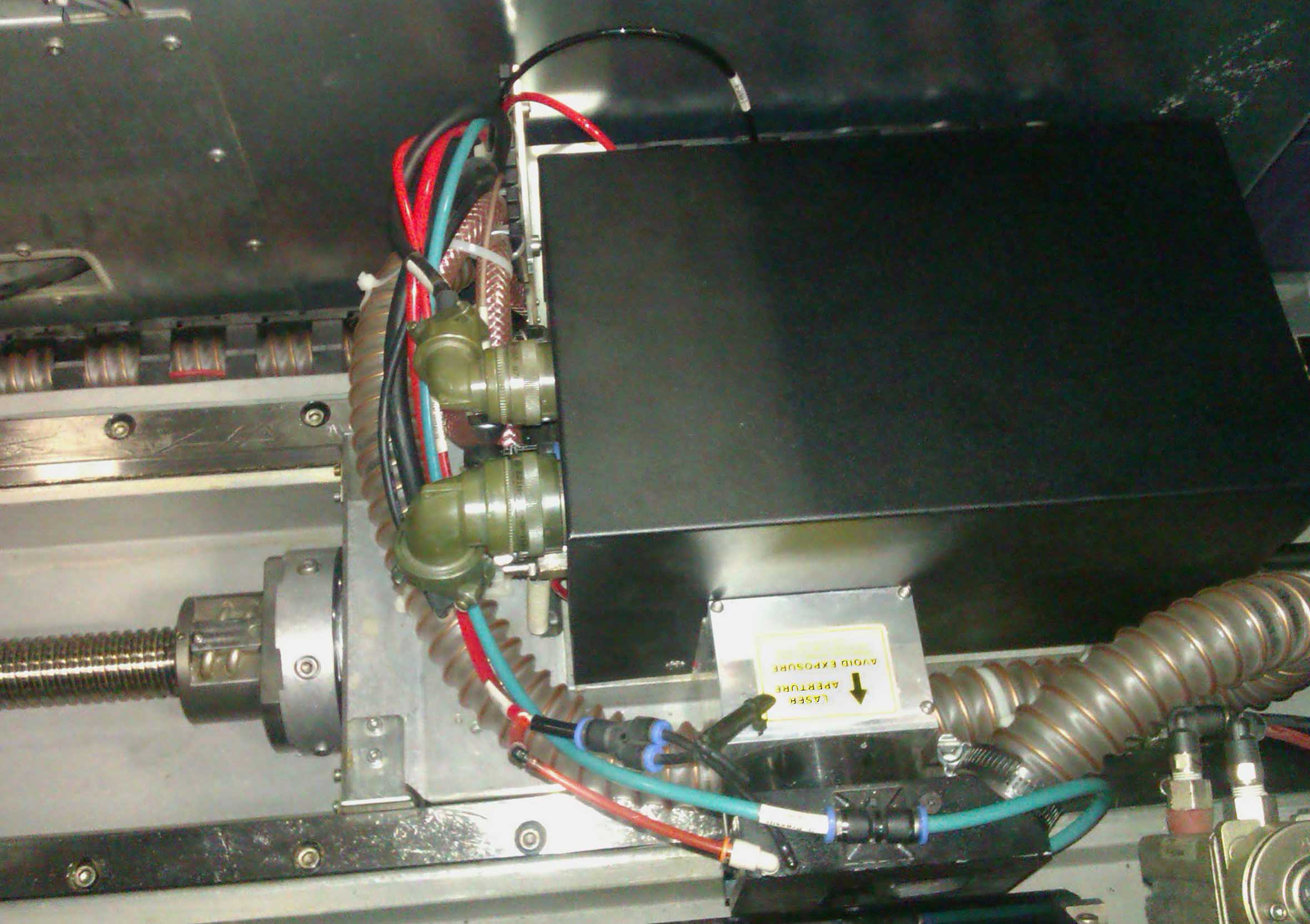

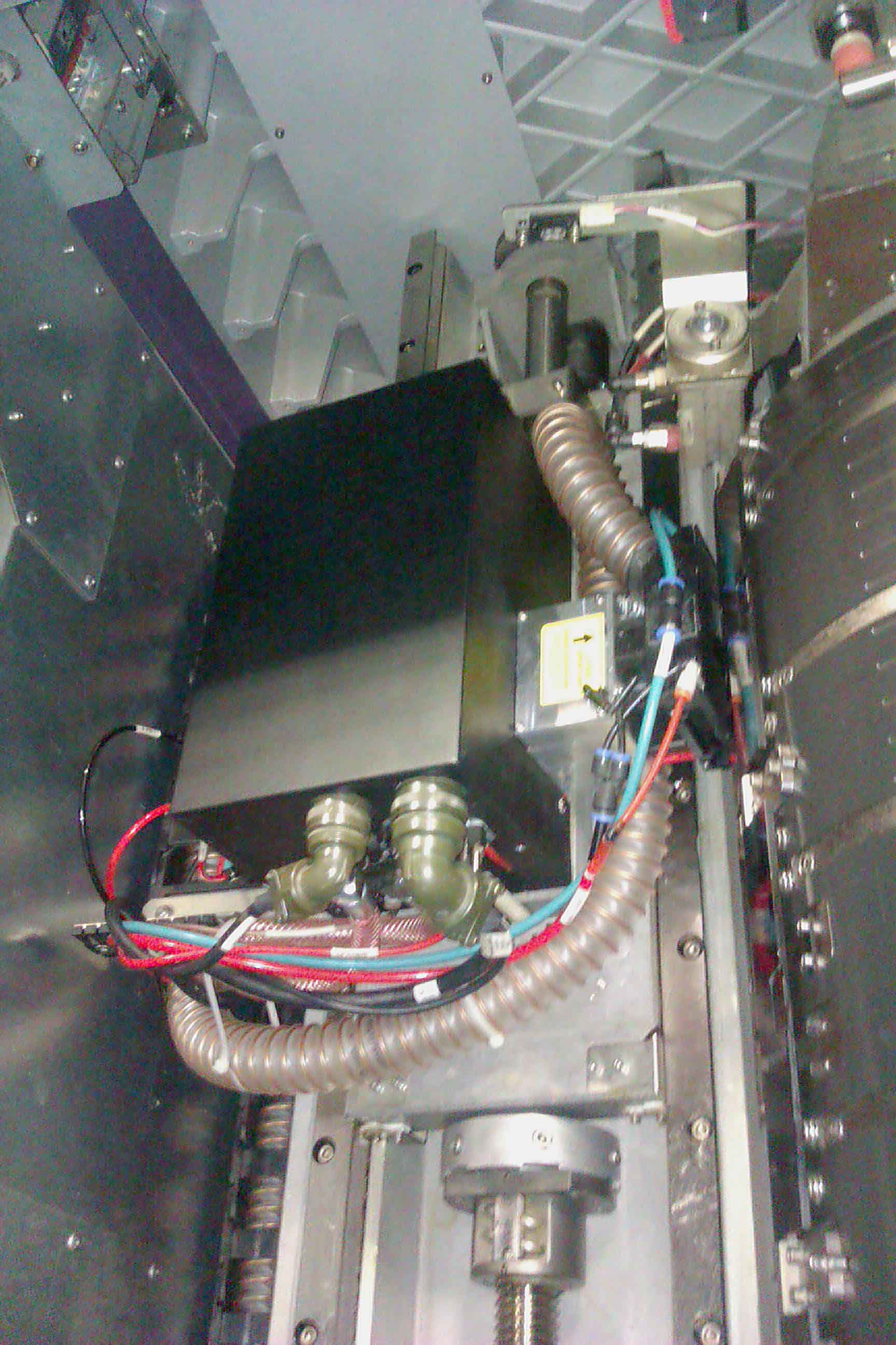

I have few information from operators (not so much as i was hoping). First time, the problem manifested this way: morning operator switched unit on, and he was able to image few plates. After this, next plates was "exposed", device not reported any error, plates was pulled out, but in fact, plates was not exposed at all. In short itme, device send error message "can not focus laser" (this is all that operator remembered). Second time, device send this error message after power on, no plates imaged.
Technician said that whole laser engine (with carriage? i think) was loose, and he must tighten the screws at the bottom and set up head, and that this is a failure that he see for the first time, and that this can not happen under normal conditions.
Some photo of head is attached, but i have only mediated information, as i was not there.

You can get Focus errors when the plate has not loaded properly onto the drum or there is a problem with the Focus mechanism inside the head. When was the Magnus installed? It looks to me that the 4 springs that used to hold the head down are not used anymore on this head. Also,looking at your pictures, the way that the Debris removal pipe was fitted does not look right to me.I do not know what screws the technician is talking about at the bottom of the carriage BUT if they are there and are loose, than the Magnus was delivered to you like this.This can not happen in the field.
