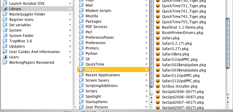

If you do regular updates the Safari pkg. may still be in the receipts folder for Software update. Worth a look.
