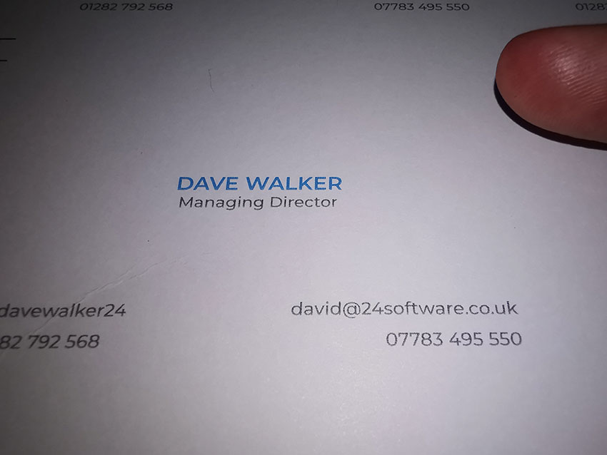

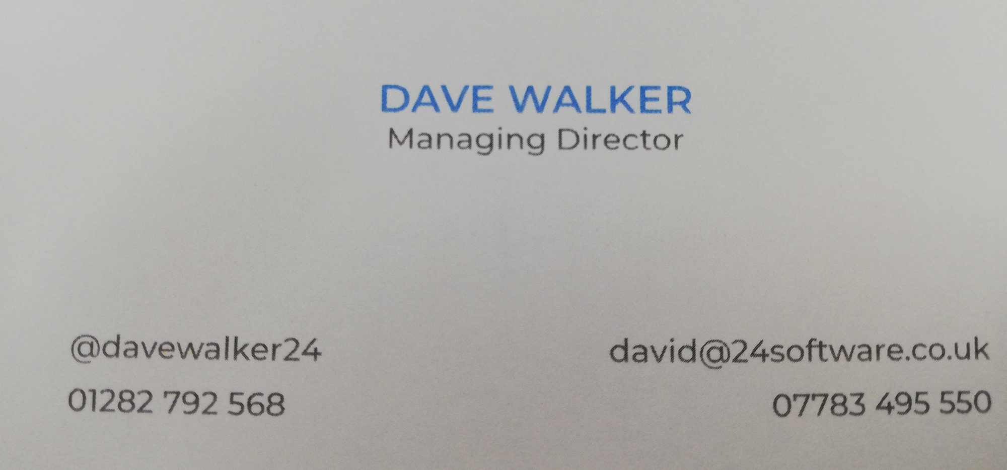

Not sure if it's much help, as I don't run a Xerox, but I've run it on my Ricoh Pro C5200 using 200 line + fine text. Could probably get it a bit better with some playing around as this was just the first print, but not showing the same issue as yours. As I say however, not much help as it's not on a V180!!!! Printed on Novatech 350gsm Matt.

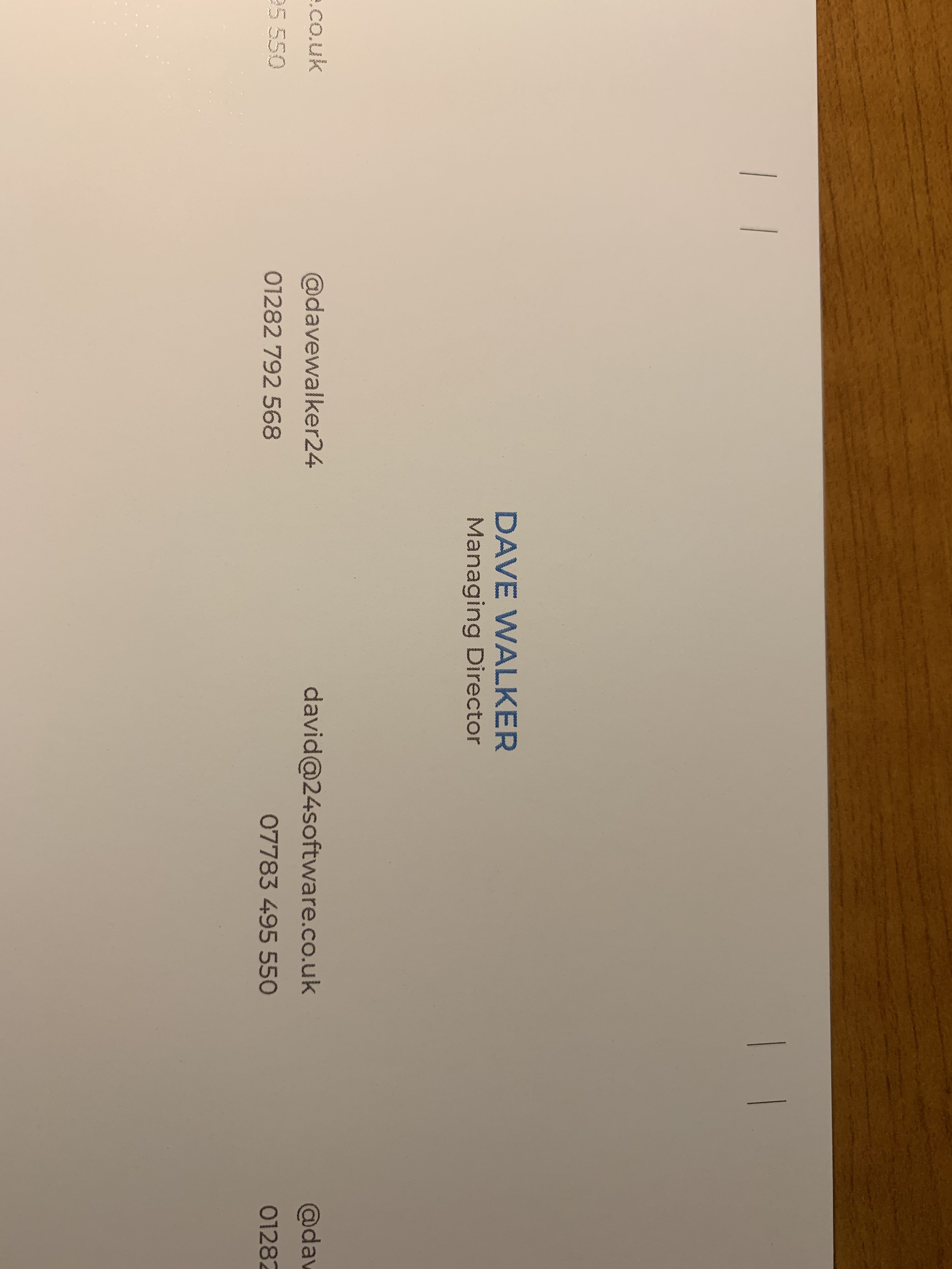

I've attached a test off our V80. Printed on 350gsm DCP (smooth bright white).
Looks a little darker in photo, sorry phone camera is crap, printed more as Cool Grey 7/8 but you can see in the test coverage is pretty even.
With my print screen mode as "Enhanced Text" I did get slight fade off at the bottom like your print but changing this to 200dot improved it to attached. I wouldn't hesitate in sending it out to a client.
