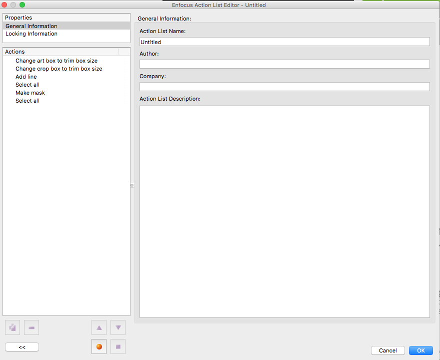

Thanks, not working for me since I have an older version of pitstop than you. See my screenshot and see if there is an action missing, I tried to re-create yours and it just deleted everything. Thanks for the help.

I see that now, we made improvements to the scaling and resizing actions in a later version. That's why it's not importing.
It's the ability to resize the masked object to a defined size (8 x 10.5) that's missing. That gives you the white borders.
