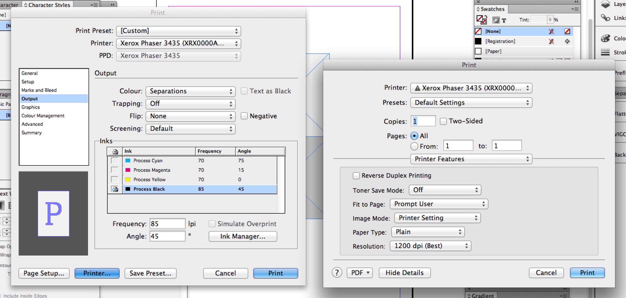

In my experience a PostScript printer driver’s halftone engine creates better dots than doing this upstream. So print to separation from say InDesign using your HP laser printer PS driver using appropriate halftone settings. Just have your images in regular grayscale or colour with no halftone filter applied, the driver will halftone the separations on the fly at print time (with better results).

It is great (for me) not having to worry about creating good laser printer dots for a Silvermaster or similar anymore!
Attached is a screen capture of the HP PostScript laser printer driver settings that I was talking about when printing from InDesign as separations to a PS printer.
You may wish to go lower than say 85lpi to get a good dot that is “clean”, even when printing at say 1200dpi. You may need to experiment with say increments of 5lpi etc.
Additionally, the “paper type” may also play a crucial role, for this demo I was only using plain uncoated copy paper, a poly plate would likely need a different setting (again testing is required or the plate supplier may have a suggestion).
NOTE: I elected to use an 85lpi screen, however the driver defaults to 70lpi which may be for a very good reason.

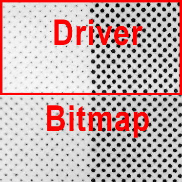

Attached are USB microscope photos of a 1200dpi laser print of a 5% (left) and 20% (right) flat tint from InDesign (linear tint data, no curve applied).
The upper image is from the printer driver and InDesign creating the halftone “on the fly” from 8 bpc “contone” data.
The lower image is from a Photoshop Grayscale mode to Bitmap mode conversion, using 1200ppi, Round dot halftone, 45° angle and 85lpi screen ruling. This method requires more work and is generally less than ideal when compared to the printer driver method.
Remember, these are only flat tints, gradients and images will be slightly different. From my experience, the dots were generally better from the printer driver than doing it manually upstream in Photoshop.
