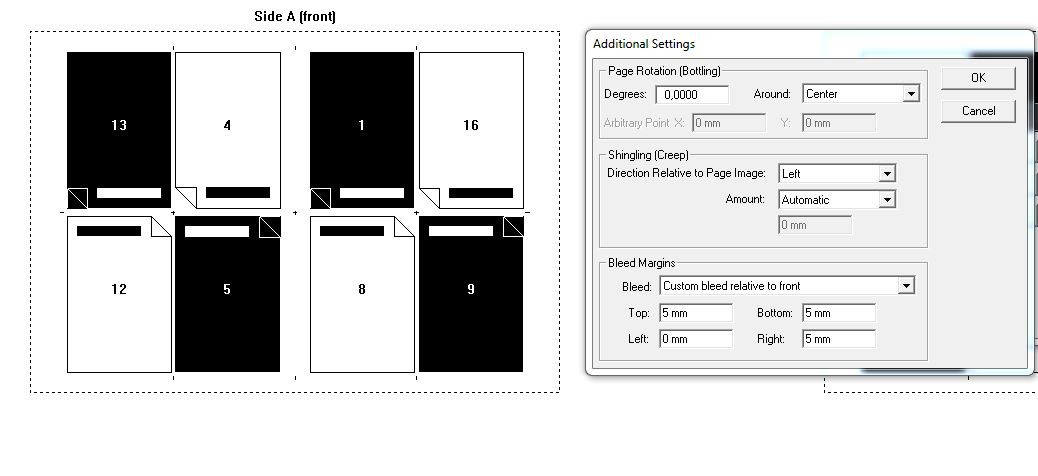

For our perfect bound work, we set the bleed to 0 on the spine side. Running Preps 8 now but has been the same since preps 5.
It changes the front and back of the sheet at the same time. You can select all LHP's on the front and change the bleed on the right to zero and it will change the left side bleed of the RHP's on the back. Then select all LHP's on the from and change the bleed on the left to zero and it will change the right side bleed of the LHP's on the back. Then make your spacing between those pages to the bleed you took out * 2 (you took bleed out of two pages so the spacing would be your normal bleed of one page * 2).
I actually couldn't find the bleed just for spine side. Or maybe I'm missing something, I'm on 7.1
For standard layout odd pages will always have spine on the left, even on the right. When you set your bleed values at the front they automatically applies to the back

Where is that option, sorry? I can only change bleed with white arrow on individual pages, not the whole imposition...
Yes that is the way you have to do it. But you can select multiple pages such as all RHP's by COMMAND+CLICK on a Mac. If you are on Windows I'm sure there is a key combo that allows that as well.
That's the job! I can save one sheet as a template and re-use it for more section if needed. Cool! and thanks

you want your standard 6mm gutter between pages, normally this is 3mm of bleed from from both pages. Your finisher has requested that area to be be white so change the bleed on the LH and RH pages to 0mm in Preps as described by Joe. You do not normally compensate for opening the book and breaking the spine. Only the glue-hinge pages where the inside cover pages are glued to front and last page of text need some allowance if you are running a picture spread across the spine.
If you are trying to compensate for not opening the book far enough to damage the spine there are no hard and fast rules as to how many mm to do this but in preps you could negative creep your pages a little, or adjust your trim boxes on the pages you see that is going to be an issue, it certainly won't be as much as 3mm
