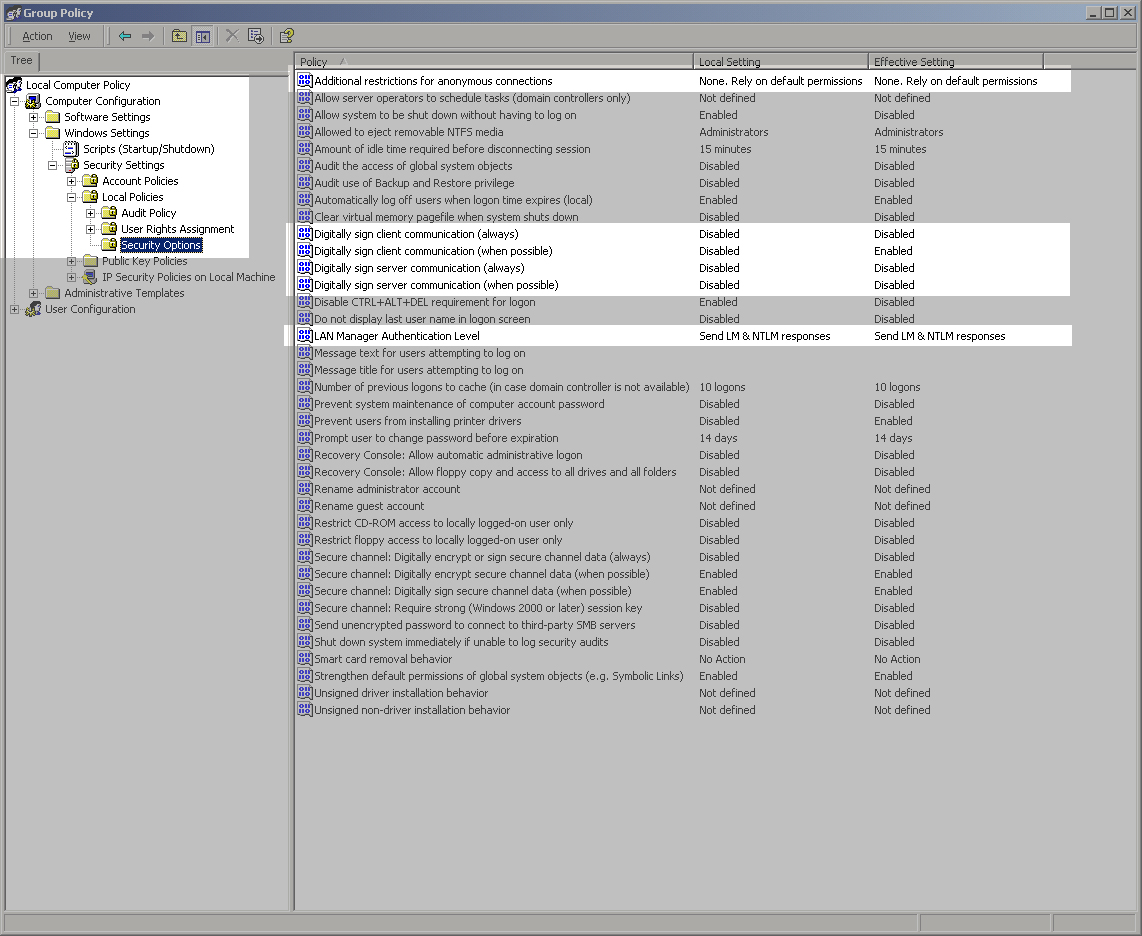

There are security settings for shares on Windows that can cause problems for Mac clients (usually older ones). I've attached a screenshot of the settings in gpedit.msc, with the relevant settings highlighted. Try running gpedit.msc and match these settings, then reboot the server. This probably isn't the issue though, as you are having trouble with AFP also. Can you post the error log you receive when connected via AFP?
Also check to see if there is any difference at all as compared to the 10.4 machines within Finder. E.g., in the relevant directories, do you have the same ability on both to list, add, rename, copy and delete files and subdirectories?

Thanks for the tip, we'll check some of our server security settings. As for the finder, only difference we really see is that under the general tab, Server: its shows my user login name before the IP number on the afp drive in 10.4, it does NOT do that in 10.5. Also see Sharing and Permissions are different. Can't seem to change those so guess that is set at the Prinergy Server. Will have to see how to access and change these settings. I can however copy, erase and all on the server drive in 10.5, as also in 10.4 so no difference there.

We tested the gpedit.msc settings but no change there. Kyle, which files do you mean with copying all of the files to a local directory?
