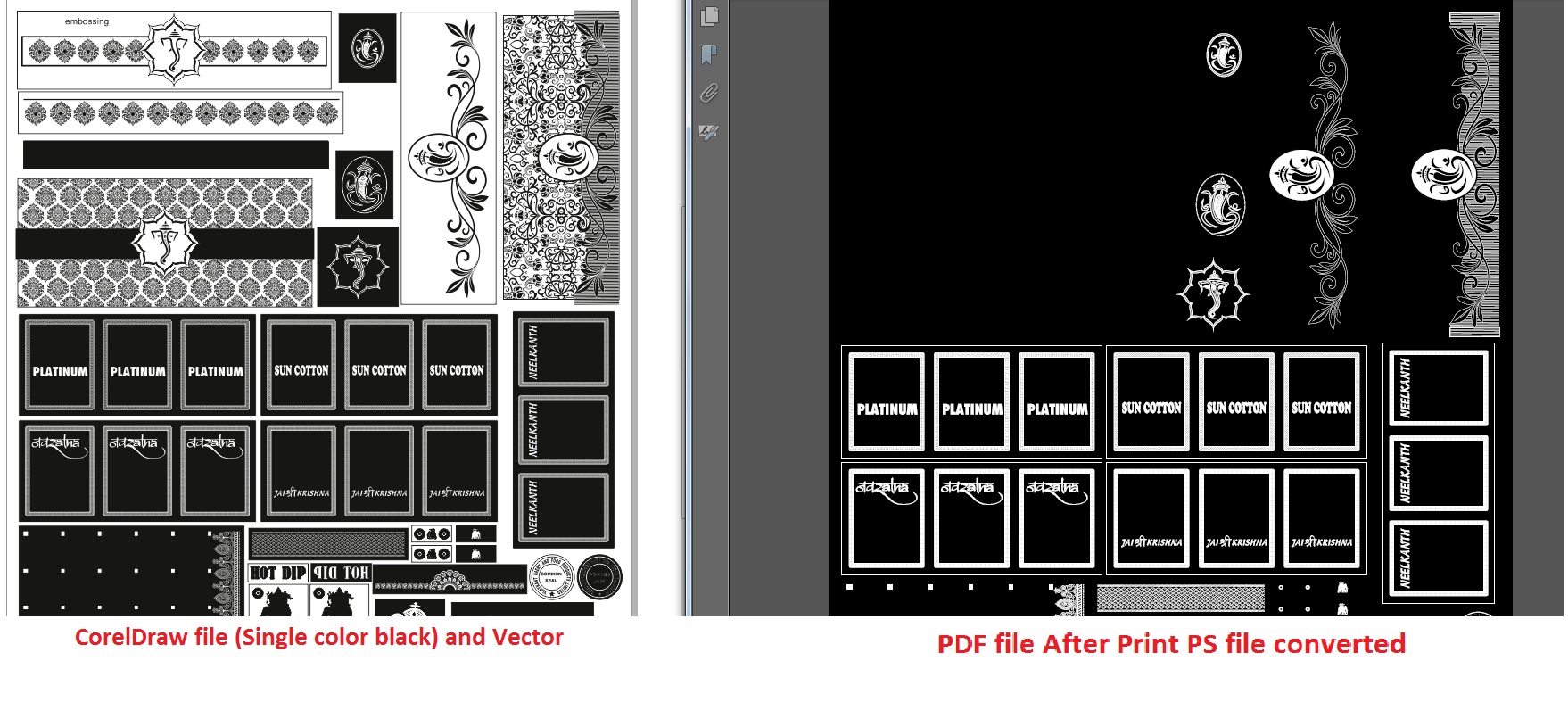

Hello guys, i need your help to fix PS from Coreldraw
I have a problem with PS when making print from Coreldraw. After print (PS) the image is turns negative and objects are missing.
At first I thought that something happened during print settings, but in print settings I don't see anything.
Please rectify the problem and give the right solution for this. I have attached the snapshot file.
Thanx in Advance.
arkay_desai
hi Madhu,
convert all text to outlines if any in file. Save as it with other name and try with selecting correct ppd.
