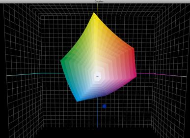

You're not gonna' be able to achieve PMS 286 in typical offset printing. Take a look at the attached. The large mass is the color gamut of GRACoL_2006_v2. The blue orb, way down at the bottom, is the position of the Lab coordinates for PMS 286 (I pulled the Lab info from Photoshop). You can see that the color lies WAY outside the colors achievable under GRACoL conditions on a #1 grade gloss stock. Now, you give me a second hit of cyan, and I can get you there.
Something else to keep in mind, bluey blues would indicate poor ink trap between the cyan and magenta inks. The better the ink trap between the cyan and magenta, the more purply your blues will become.
