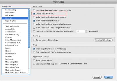

Don't forget about the setting in Acrobat Pro itself which attempts to recognize links as URLs.
Greg

--And Greg, he already mentioned that preference in original post and that is not what he wants to do as far as I can tell.
